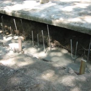

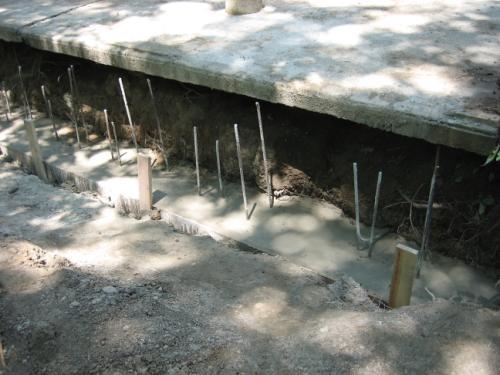

Well, thanks to all the help I received here, I am happy to report that I have poured the footings for the retaining wall with the rerod set up as suggested. I was 96 degrees with a heat index of 105 but with the help of two friends we got it mixed and pured in one long day. Here is a picture of the finish pour. Now it is on to the cement block. Again thanks to everyone for your great suggestions and information.–Bill

        Third times the charm.Aattached are larger pics, I hope. If not you can get the gist of the construction site from the first attachment. For the questions and comments, see my original post under "retaining wall question".

          What's inj the blue bags?  Pre-mix concrete?  How many bags did you use?
          1. PRSVRNC | Aug 01, 2006 03:46pm | #5
            Yes, that's premix concrete. It took 318 60 lbs bags. I couldn't get a truck in close due to trees and a septic on the only partially open side of the house, so I hauled in the premix and mixed it on the site.
