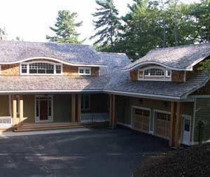

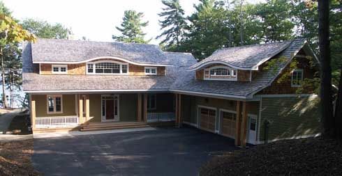

    Gene_Davis | Jun 03, 2008 06:14pm | #23
    I would build this, for which the plans are available from Robinson
    Design.  A lot of people might say that stock plans are junk, but not these.
