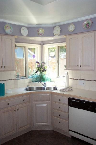

I came in after the customer had their dream kitchen designed in their head. Now I just gotta try to make it all fit as close to their pic as possible.
To top it off.....they're moving the sink from under a window....into a corner that's going to have a diagonal upper cab as well. They're set...who am I to argue?
Tiny little kitchen....with very little room left for base cab's....so no base butchering is gonna happen...they need all the base storage they can get....I'm not even gonna alter a drawer.
So I'm stuck with trying to wedge one in...or go single bowl.
Hey Cal.......those 2 side cabs untouched? Drawers still work.....not cut down?
That app looks good with the windows above.......
I haven't wedged a big sink into a small corner as of yet......for my tastes......this is gonna look way to tight(with the upper)...but I don't have to do the dishes there.
That Kohler Urbanite is looking better and better......the closer to the front the better....
