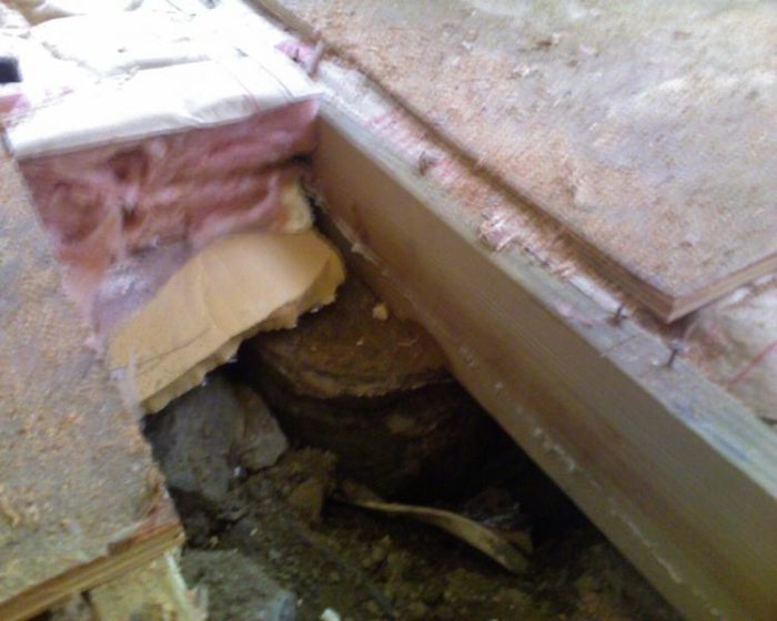

Good idea re the picture Piffin,Here are 2 pics, 1 of the exterior footing in which you see the junction of grade and siding with one PT timber removed to reveal the footing and another PT timber still in place to the right. THe other picture is a bit fuzzy but hopefully you can make out the sub-floor that's screwed to the PT 2x6 joists and the footing underneath. You can also see that the they had attempted to seal the room above with rigid insulation but the insulation was cut too narrow and there's plenty of space for water vapor to get thru and it did.I look forward to hearing your suggestions. Let me know if you need more description or more views.Thanks very much,Don
OK, Don, the confusion in your email was because this post was to "all" instead of to "Piffin" so it never came to my attention again.In the fuzzy photo, what is the fuzzy brown stuff under the insulation?In this case, I believe the insulation is installed wrong side up. Normally it would have VB up, but that is because normally you put it on the side3 of the moisture source. but with this addition right on the ground, the source of vapor pressure is from the soil up. They should have built with slab and VB under it. I don't see any other way to make it really right. Even with PT, there are too many other problems created.How to do that now is going to call for some planning, to be able to hold the structure up while floating the crete in under it and demoing all that junk out, possibly doing soils and drainage work....I don't envy you
Thanks Piffin,The fuzzy brown stuff is 1" foil-faced rigid insulation board. Dirt's under that. You don't see a need for a 4' deep perimeter foundation?Thanks,
Don
I don't know the soils and drainage situation there to say about deep foundation. You can do a FPSF system with foam and drainage.General principle I like to follow is to use same foundation the rest of the house has when I do an addition.That foam they used may have been a good idea had it been done well and sealed, but the foil on top then created a double VB.
