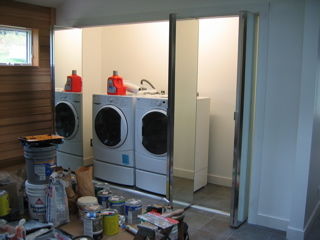

Every now and then I have a customer who is somewhat able and doesn’t screw us up too much during the renovation, but I still must watch out when they are buying things and trying to speed up the project by doing so. I slipped up.

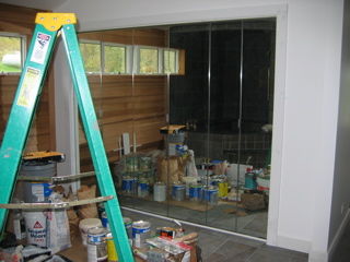

I have a 8′ opening spec for mirrored ‘bi-fold’, closet doors. The opening wants to be clear because it has a washer dryer AND folding table to fit in it. If the doors are in the way when open it defeats the purpose. Well that would be 2 pairs of 2 connected 24″ mirrored panels . 4′ each making up the total 8′. That is too much weight for normal bi-fold hardware and I was surprised to learn no one makes them for that size configuration and no one apparently makes an accordion set up for such an opening. i.e. 2 sets of 4 -12″ doors.
I researched this and had concluded I would have to custom make them using some heavy duty accordion door hardware and mount the mirrors on 12″ blanks. total costs amounting to about $2,000 all said and done. Then customer has closet & door company supplier visiting to size up for huge walk in shelving system in another room. He says to my client, no problem they have a supplier who can do this door. I speak to him once and make sure that he understands I want clear opening of +/- 7′ when doors open. He says no problem. I make sure they will measure rough opening themselves and send us the door to install. ..
Unbeknownst to me (is that a word?) he then calls the client back and client ends up telling/ordering him some configuration ‘caus udderwise the duhs wud a bin in front of da dryer”. Turns out the closet salesman actually did not understand the need and sold Richie (my client) what my client thought i wanted. Both of these guys did not understand the problem. (The wife did). Now I wasn’t there and my guy installed what came and it leaves her with a set of bi-folds between the dryer door and the folding table.
What do I do? ..

But Johnson makes bi-fold hardware that allows the doors to open all the way and fold back against the walls.
IIRC then the opening is the same as the trimmed opening, making 1" less on each side.
He's right, your research was inadequate. Johnson has the hardware you need. I believe that Sugatsune` does also.

In our copy of the Susanka "Not So Big House," I outfitted the laundry closet, just as she did in the original, with four 1/6 paneled cherry doors, hinged together and riding on the Johnson heavy duty rotating trolleys, so they all accordian to one side. Your setup will be this, doubled and mirrored, with 1/0 doors.
And after Ron takes care of you on this one, continue to be a loyal customer.
You will likely have to re-hinge and patch some door edges, but you'll be OK.

I hope I was clear in my post that I did take ultimate responsibility. I dropped the ball in at least two parts of the screw up. One part letting the client be so involved. I just returned from site and talking to clients. I basically said to them that "we" have a screw up. I apologized for not catching it as it happened and then suggested I would pay for some of the fix. I suggested we would remove and prep for the new. etc. and would share the new cost. At this point the client turned around and said he saw how he had messed things up.. his wife standing there agreed.. and suggested she could actually live with it the way it was. Then laughed saying she was probably not going to be doing all the the laundry anyway. So right now we have resolved it, sort of, but I would rather do the complete fix so that the irritating door doesn't hang around as a reminder for years after we are gone. We'll see. Thanks again.Arthurhttp://www.thesmallbuildingcompany.com
