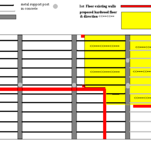

hi all, just looking for some advice on laying new 3/4″ t&g hardwood in my living room….. there is an attachment here that gives alot of the details…. the joist dimensions are shown at the top…. the new floor would be going on top of old existing hardwood in the same direction… I understand the ideal situation of the flooring being perpendicular to the joists, but with my situation the original was laid parallel…. the subfloor IS perpendicular, with the flooring parallel… is this allowed because of the position and size of the large 8 x 8 beams?? also, based on my situation, what would some of the recommendations be…. the big boxes don’t have always the best answers, at least ones that I would always trust…. thanks in advance!!!! Todd

  2. Piffin | Oct 11, 2007 12:34am | #3
    OK -- Have seen it now.
    What is not clear is - in elevation, what is above the joists now? What shows on the diagram is opnly that finish flooring would go in the same direction as the short joistws.
    Is there plywood subfloor? 1" boarding boards for subfloor?
    I have no problem with a T&G finish floor running with the joists, IF the subfloor is right.
    Still unclear if there is another fiinished floor above a subfloor or ?????

      alright, let see if I can explain this right.... basically there is existing subfloor and floor above the joists shown... the subfloor IS two layers totaling 1 5/8", and the existing hardwood is 3/4"... the reason I want to just put new over top is that at some point there were some boards replaced and those new ones were face nailed, not to mention a different width board.... so, it looks pretty patchy... they probably didn't care, because they were replacing with carpet.... I was thinking to add to the top of that with the new 3/4" hardwood, I'd really hate to rip anything out, its about 240 sf.... so, should I just use floor leveler? re-plywood? or just go over top with the new? on a side note: there is no bridging between the joists, with adding more weight, is it something that needs to be done or not??? if so, any tips in making that any easier???hopefully I gave everything needed, if not, just ask, I will answer anything I can....thanks again in advance, Todd
