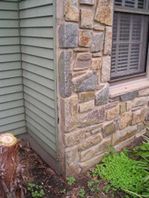

Adding a 2 car garage addition to the side of this house. The addition will extend 8′ out from the front facade. The 8′ of new garage wall will join into existing wall of the main house perpendicular to the stone front . What would you do with the stone where we have to connect to the main house? One framer said “let’s just butt up against it (the stone) and caulk the heck out of it” Initially, I thought I could take a diamond blade and cut out a 4″ section but my concrete guy said that the stone is too hard.  I guess, my other alternative is take a cold chisel and chisel out the grout and remove enough stone to make the connection and then have the mason reset the stone when he does the front of the new garage (the short 8′ side wall will be siding (hardie).

    Diamond blade will cut it but you will not be able to reach the full dept of the stone with a circular saw -- reach maybe 2" -- I just put up 75 sf of similar stone and needed to tailor each one -- lots were too wide so needed to rip -- However, if you cut all as deep at you can and then use a 3-4" brick chisle and a 4 pound hammer they should all break in a straight line -- some of yours almost look 4" in width so you might just tke them out an rip on a table -- may need to repoint the area around the stones becase it may work lose -- alternatively you could rent one of those gas powered diamond blad saws and cut right through to the sheathing
  3. donpapenburg | Oct 03, 2004 03:42am | #3
    That looks like fake er a cultured stone . That stuff cuts with a butter knife ,well sorta .  A diamond blade will do just fine . use a demo saw to cut the full depth that way you will not have to do any pounding that will loosen ajoining stones.

      based on the other siding .. and the corner ... it's cultured.
      Just cut away.
      circular saw or grinder.
      that'll give a clean ... ie ... straight corner.
      me ... I'd be inclinded to pop some stones and tooth in the new work.
      would look less like an addition.
      one old side ... one new side ... work your way up or down.
      weave it.
      real stone walls don't have perfectly straight corners.

        Thanks for the advise everyone! Nope, the stone is the real deal...about 4" to 5" thick. (house is 30 y.o so i think it's pre precast stone days) I'm going to try cutting it with a diamond blade. Good point about the blade leaving an clean/unnatural line, but the siding on the side wall is going to but up against the stone so it shouldn't be an issue. Cutting it back a good 4+" will allow me to properly flash etc in the corner. If the blade doesnt work plan B will be reweaving.

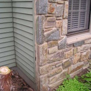

        Real stone can inded be straight cuts. See tjhe backs of the stone at end of wall? They are irregular backs. Fake stone has flat backs and are not as thick of a wall. The colouring also looks real to my eye.

    If you're having the mason finish the work, call him in now to pop selected stones in which he can make his work easier then as well as yours now.  It'll take him but a few minutes and ultimately be done right.
