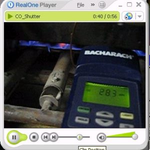

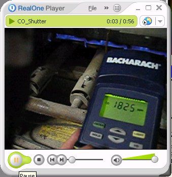

I’ve enclosed 2 photos (CO_High and CO_Low)  from a CO analysis I did a couple of days ago showing the effects on CO readings by opening and closing the shutter.
The CO meter probe is in the top of the heat exchanger (outside of the image area) and you can see the large difference in CO with the shutter (i) opened and (ii) mostly closed.  (On this furnace, the shutter is a sliding tube to the left of the CO meter.)
CO levels greater than 300 parts per million are generally unacceptable – under the BPI CO Analysis protocol, if CO is >400 ppm the gas appliance must be disabled until properly serviced.
The CO level in the CO_High image exceeds 1800 ppm.
