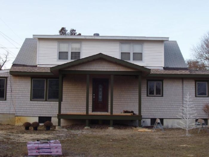

I’d like some opinions on my project. As you can see, Ive re-sided the first story of the house w/ white cedar shingles. I do love the look, but it is time consuming for an amateur such as myself. I was considering white cedar clapboards/bevel siding for the shed dormers but I/m not sure if that would be aesthetically pleasing or architecturally correct. I’m pretty happy w/ the job I’ve done so far and I don’t want to sacrifice a nice end result for the sake of saving some installation time. I’m also having a tough time visualizing running the shingles where the shed dormer meets the rake (?) on the gable roof. If anybody has any opinions or advice on either I’d be grateful. Thanks, Craw
it's time consuming because you're doing a great job.. and it's not something you do all the time...
sometimes a traditional house might have painted clapboarrds on the front elevation and white cedars on the other three sides..
but you will not see WC ont eh front and claps on teh dormer above.. in my opinion, i'd continue the nice job you're doing and repeat it on the dormer
a couple of tips... the cheeks of your dormers will have step flashing up the sides.. use either brown aluminum step flash or black alum step flash... lay a piece of 3/4 board on top of the flashing and don't let any of the butts get closer to the roof shingles that that.. it will keep the butts air dried and they won't wick water off the roof..
you have to install the step flash before you do your sidewall shingle..

Thanks for taking the time to reply,Mike. I've seen alot of your work here on Breaktime and its a real morale booster to have my work complimented by crafstmen such as yourself and many others here. So shingles it is. Thanks again.

Thanks to you as well for the compliments. The shingles are Maibec pre-stained with Cabots bleaching oil. They have 3 grades and these are the middle grade shingle ...I don't remember what theycall them. For me its well worth the extra expense of having them pre stained. I dont know if you can see the porch addition all the way to the right of my picture but those are some locally purchasedw/c that I hand dipped in linseed oil, bad move. In addition to selling me on the pre-stained the linseed oil really seems to promote mildew. I havent seen any mildew on the shingles or soffit that was treated w/ bleaching oil.
