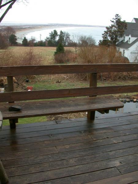

while we were waiting for the plasterers to schedule in on the porch job, i took a deck rebuild in Middletown… overlooking Second Beach and Purgatory Chasm..
here’s the view..
here’s the view..
replace about 1/3 of the framing.. ( 2/3 replaced about 6-7 years ago)... new rail... lose the built-in benches ( not to code )..
the old posts were 4x10 cedar.. but the band joists were rotted out..
