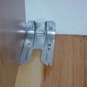

We bought a new elec range last year and I finally got around to installing it. Included with it is an anti tip bracket. It’s supposed to mount to the wall or floor, and then the adjustable feet willl slide under it.
If it matters, it’s a Maytag Gemini model with the dual ovens and not one of the big upright models. I did try and see if it would tip by opening both doors and adding weight to the fully extended racks. It’s not going anywhere.
Is this just another example of the manufactor limiting it’s liability or is it a valid concern?
thanks

      The ones I have seen @ work  that are installed by the GE guys mount to the floor. As long as you get it to hit something solid I don't think it matters.
       Good safety feature especially if there our kids in the household.

      No young kids here. I installed a floating floor so X that location out. If I really should use the brkt, it'll have to be on the wall. Hopefully a stud is in the area.
      BTW, commercial work I can understand why, but is this something new for residential installation or has it been around for a while?

        Is it a "valid concern"?  Not to most people with common sense, but we don't live in a world full of common-sense people.
        Let's put it this way- when I lived in Las Vegas, my wife worked for a company that did destructive testing and repairs for construction defects lawsuits.  Of the 15-20 repair projects they did a year (averaging 100 or so units each), what was the item that was common to every one?  "Install anti-tip bracket on range".
        Builders never seem to put them in, yet the defect lawyers always find them missing.  I can see it in court- "if the builder was unwilling to take 2 minutes to install the anti-tip bracket on your stove, imagine all the other ways he probably cut corners during construction".
        Are they "needed"?  Not for most people.  But for the little effort required to install it, why not?  It may save some kid's life some day (or a stupid adult who decides to use the oven door as a stepstool.....).

    It is a valid concern.  Years ago no one thought it would be -- we were all thinking like you, pushing on it and finding it pretty solid.  But people have actually tipped stoves over.  Sometimes a child will open the door and use it as a step, or someone will set a heavy turkey on the door, or even an adult will step on it to reach something in a cabinet over the stove.
    We would all ball out my grandmother for pulling out the bottom drawer of the china cabinet and stepping on it to reach the higher shelves.  She wan't a very tall woman.  She made it to her mid 90's and passed away without ever falling off.
    In the book "100 Most Dangerous Things in Everyday Life", the author cites statistics from the US Consumer Products Safety Commission that between 1978 and 1995 there were 37 deaths and 113 injuries from people who tipped vending machines onto themselves.
    In the United States each year, about 7,477 people are injured by dishwashers.  Occasionally they are fatal, usually adults or children falling over the open door and landing on a knife incorrectly placed point up in the rack.

    think about a kid openning the oven door to use to climb up to "help" mom cook dinner, only to tilt the range forward and slosh hot liquid all over himself.

    Some lighter weight stoves, usually the electric ones are a little lighter than the gas ones, can tip forward if a large roaster pan, full of course, is rested on the open stove door. The open door presents a significant amount of leverage. Not uncommon for people to grab a large pan, slide it off the rack and then place it on the door so they can get a better grip.
    In this case both the hot pan on the open door and any pans on the stove top are at risk of sliding off and spilling their hot contents if the stove tips forward. A major burn risk. And having a hot stove roll over on you might ruin your day.
    Of course kids climbing on the door are also a risk. Both falling and burns.
    The anti-tip brackets are, IMHO, a good idea. Most I have worked on are relatively simple to install so the added trouble is minimal. IMO it is a favorable tradeoff and a reasonable requirement.

    With some of the drop-through-the-counter and slide in (over/into counter) models, the wall mount bracket is the only way to get the range properly oriented to the countertop.  Otherwise, an unlevel floor will be just caterwhumpus enough to not adjust to the countertop.  Balancing the range on the counter top will get client-happy gapless installs, but will not then properly support the range i nuse.  Ergo, a bracket is needed.
    Now, are there installers out there leaving them off.  Yeah, sadly.  About the same number (if not the same people) who think that a 4 wire 220 dryer or oven connection are "dumb" and just ignore the difference.  Besides, the house is one of the $175K "starters," no worry about fancy folk with lawyers living there--right?

      Just for the few that have never installed one. Installed this one about an hr. ago, for the GE brand stove. Took all of 1 min.
