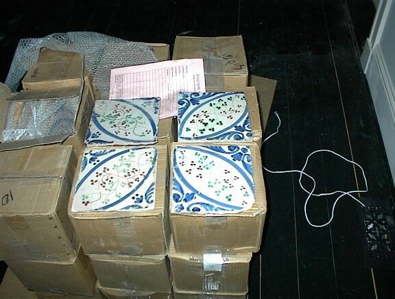

Something else Take a look a the photo and see the pattern. I am confused by one incongruity I find in my inspection of these. If you will look at the painted pattern of the flower in the corners of each, you will see two different flowers. I would interpret these as male (having three dots representing stamen) and female (with a fuller flower and no stamen or dots above).
I am unsure of the best way to use these two in a pattern together. Sometimes antique tile sold at art houses or auctions are accompanied by a photo showing how they were originally installed. It seems to be about 50/50 mix in the dozen I have looked at so far.
Anybody got ideas on this?
Paul, take the lower left box and swap it with the lower right. Turn the pattern of each to what the other was............oh boy, this isn't easy describing.
The dotted tile will run on a diagonal with the oval going the same direction. The undotted tile will do the same except the oval will be opposite.
The same oval pattern you have up there will be the result, but the dots will run in a diagonal line across the floor.

What Calvin said, or set them in groups of 4."Put your creed in your deed." Emerson
Thanks - that makes sense. I had thought of the groups of four, but the junky layout of this kitchen will leave something unbalanced.These will need close inspection and cleaning too, so I plan to do the layout simulated on the floor of the adjacent room. Then I can photograph it and email to owner and interior designer (whose miscarriage this thing is) for approval.
I have an appointment for a phone conf with them this afternoon to get their thoughts. I don't know yet if either of them knew there were twin patterns or if they got stuck...Gotta run to see the crews now.

The female ones have a more vivid bright blue and a lighter coloured background
There are slightly more female ones than male, and the male ones tend to have more chipped edges etc.When you look at the photos, you can easily see how the female tiles make a brighter, more vivid pattern while the males when grouped all together make a duller dingy shadowed look. When mixed together, the patterns do not meet well,and the sizes are harder to use to maintain a smaller grout line.I believe it is clear that the obvious solution here is to lay the female tiles for the majority of the center of the floor where they will be most obvious, and fade to male in the perimeter and where shadows fall. "

You asked opinion this a.m. I gave you a pattern. Do any of those pics depict that suggestion? I couldn't find those two dots if you blew 'em up so big it would take you an hour to load.

The last one mixed was your mix, Calvin. I'll name it the Calvinato style after you!;)The differences jump right out at me but details is one of my strong points - to the point of being a handicap sometimes. There comes a point in art appreciation where you have to learn to step back a little further and squint just right to appreciate the beauty.otherwise known as a two-bagger

Watch those gout lines. Make sure the patterns line up well with the proposed grout lines and make sure the client signs off on a tracing of four tiles in the proposed spacing.

Signing off - that's why all this attention to detail and photo sampling! These gaumie things vary in size from 7-1/8" to 7-3/4". Most are close though to 7-1/2" They are mostly more true than most Mexican tiles I've used.Dumpster diving - No, but this ID loves old stuff. I once saw her rub her bod over an olde door exclaming, "Can't you just FEEL the olde vibes!?"California flakey blonde. The ID, not the client.
