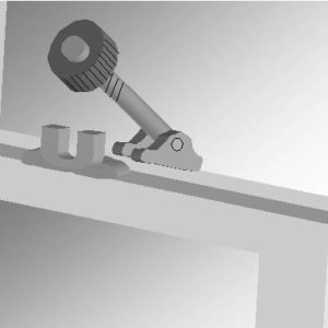

My wife and I were in England and Scotland this summer and saw some window latches (for double-hung windows) at some ancient buildings that were fantastic. I’m attaching a rough sketch of one to this post. They were great because they didn’t depend on the top and bottom sashes coming together exactly to close–which is certainly the story at our 1840 Greek Revival home.
Does anyone know where I might find these kind of latches? Or at least know whether they have a name that might make for easier searching??

The end is a thumb screw, which you can tighten down quite a lot. It's not foolproof, but neither are any of the other more modern one's I've seen (and of course the glass is always easy to break if you're THAT determined...

You've hit paydirt. A Google for Brighton Fastener gets many choices -- unfortunately, none are in the US.
Brighten Fasteners! Thanks so much. That gives me the terminology I need to keep an eye out at architectural antiques sites and ebay!
