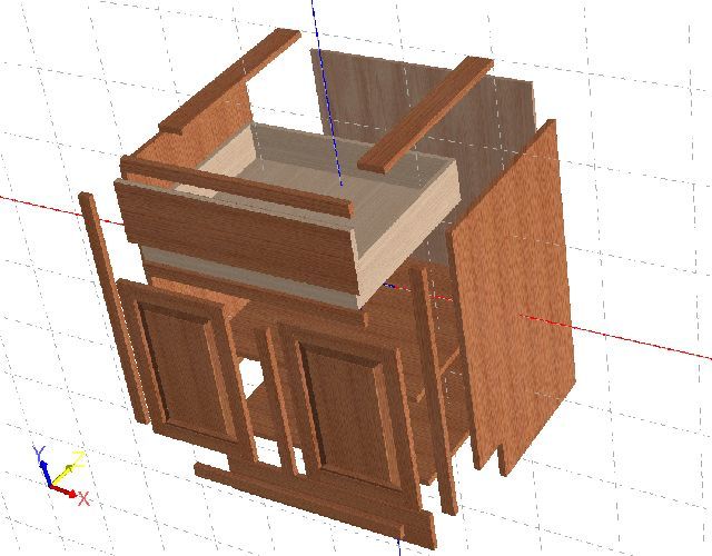

Here's a sampling of what it is like designing and building cabs with the eCabinets software.
Unless you are doing some really funky advanced stuff, you are never "doing CAD drawing" with the software. Mostly, you are setting parameters and sizings. An example of a parameter is "full dado backs into sides and decks, dado depth 3/8", clearance sides 0.020", clearance bottom 0.020""
An example of a size setting is "Toekick height 4""
The software comes with already-built "seed cabs" for both frameless construction and faceframed construction. Basic wallcabs, basecabs, corners, etc., are all there at the beginning in the STANDARD cabs library.
Your job with the software is to pull one of the standards into the program's editor and modify it so it has all your size and build preferences.
Here is a pic of a faceframed base, one drawer over a pair of doors, with an adjustable shelf in the space behind doors. I exploded it a little so you can see the parts. Joints are mostly butts, with a few full dados, exactly as might be done in a "saw" (read: not CNC) shop.
Throw that cab into a job "batch," run the "nesting," and you get output showing how to cut parts. Here is the part for the faceframe parts.
I did not change the setting before nesting to say "all parallel cutting, use 0.133 kerf," which I would do if saw cutting and using my good rip blade, so what you are seeing in these nest pics is as if the parts are cut on the CNC. But you can get the picture.
Here is the pic of the part of the cutting done from 3/4 plywood. Since this cab has 1/2" ply for its back, plus a drawerbox with 5/8 sides and a 1/4 bottom, there are more pages of nested parts.
What you are seeing are the "nest" outputs for a batch that contains just this one cab. A whole job might show the nesting for the 3/4 ply parts as requiring, say, 22 sheets of 48x96, and the nest drawings will run for pages.
You can specify doors and drawerfronts as "build in house" in which case you will see parts for those items in nest diagrams, too. If you specify them as "outsourced," then they show up as output on the "buy list" and are scheduled out per size.
Here is the beauty of eCabs and other programs like it. Once you have built a library of YOUR SEED CABINETS, meaning one each of every type you plan to build (H, W, and D not important in the seeds), then doing a job with the software means just bringing into the batch (or room) the cabs, one by one, giving specific H x W x D to each cab as it is added to the job.
A seed built as 27 x 34.5 x 23.75 and then resized at batch time to 29-7/8" x 34-1/2" x 25" creates a new cab with all the parts resized. Seeds are used over and over.
Edited 2/1/2008 8:40 am ET by Gene_Davis
