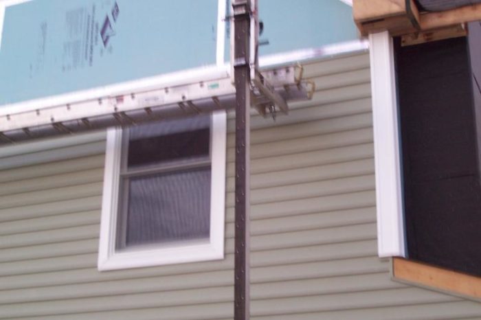

I bought a set of used Alum-A-Poles and scaffolding to put the vinyl siding on my house. I have to say the things are great but man do they wobble! I’m wondering if I set it up correctly. There were no instructions except on the sides of the poles but I could barely make them out. I’m going to try and attach some pictures of the way I have it set up. Also I’ve posted on here quite a bit so I’m also sending one picture of the house since the new second floor went on. Any advice is appreciated as always!
Thanks,
Craig

but near as i can tell... they are wobbly because you are pushing the envelope on the ht.
your brackets are up on the roof, so i'm assuming they're near the top of your 24' poles
after you pump up aways, you can set a 2d set of brackets UNDER your plank.. that will take the wobble right out
are you using two poles or three ?
a three pole set-up is a little stiffer ( side-to-side ) than a two pole set up
the wall braces are pretty good, do you use lags to secure them ? and the angle of the diagonal brase to the straight -arm brace.. that should be as close to the horizontal as possible.. so the diagonal will resist side-to-side sway
I'm assuming everything is kind of swaying back and forth as you make your way up the wall.You know those brackets that are clamped to the top of the pole and secured to the roof.If you add another bracket midway up the pole and secure it to the wall it will stabilize it quite a bit.Shingle up to the middle bracket,attach a couple of short shingles pieces on either side of the arms to give you something to clip the next course to.Leave the bracket attached to the wall,unclamp it from the pole,pump up above the level where it was attached to the pole,and then clamp it back on the pole.You'll feel like you're standing on the ground.On the way down,pull the middle bracket and the short pieces,and fill in the gap with a full shingle.

It's kinda hard to tell from your pics, but as Mike sorta said...the upper standoff braces should be mounted so that the straight rod is perpendicular to the wall and is positioned straight ahead dead center from the pole, and then attach the angled rod so that it controls any left to right movement. Horizontal bracing helps a little too, but if you secure the Pics(planks) to the jack using the chains, that'll snug things up a little more. As for fore and aft movement (in & out from the wall) add another brace 1/2 way up the pole or under the Pic your standing on. If your end poles are close to the corners, you can add a brace 1/2 way up on the outside of the pole and tie off to the side wall. That way, no bracing will be in your field of work. You could also back brace the poles to the ground with 2x4's. Plenty of ways to stiffen it up...it just depends on how anal you are.

almost forgot...watch out for the safety police. They lurk here in the shadows. You'll get cited for no fall protection. Get a harness, netting or put a back rail in place. It looks like you have the bench brackets above your jacks. At least put a Pic or 2x12 on it and you'll be safer.
Your braces are not set up right. As others have said, the main arm needs to be perpindicular to the wall. Also, set the braces so the angled arms oppose each other. Put a pic on the worktable brackets and the added weight will stabilize the rig a little, plus make you feel safer and give you a place to set your stuff.

As a few mentioned, look at the brackets and understand how they work. When they are horizontal, or as close as possible, the bracket only would allow movement up and down which when attached to the pole and the roof/wall will not happen. If you have them more towards vertical, the pivot swings around and will allow the pole to move side to side somewhat.
