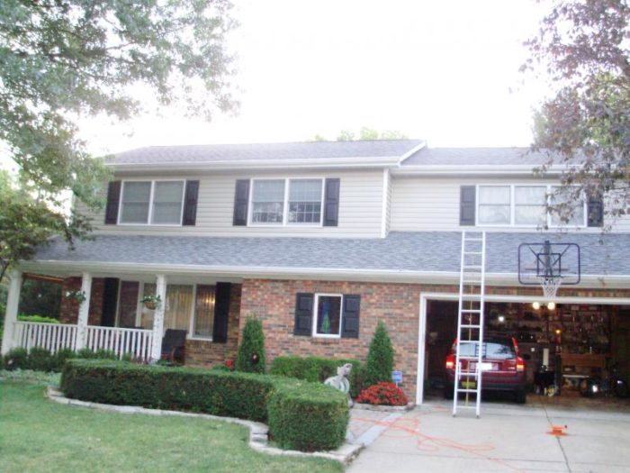

Ive attached a pic of 1) the house (faces south so lots of sun on the grey roof)

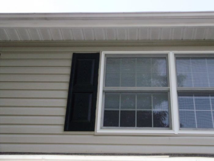

2) close up of a soffit which has a continuous vent the length of both eaves, the perforated vinyl type I believe, and

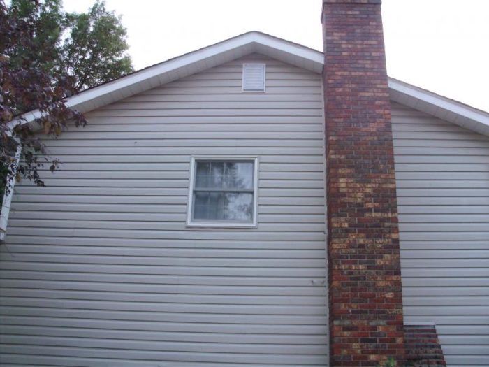

3) a gable view with now sealed off vent. I sealed both gables today, one on each end of house (east and west).When insulation was blown in Im thinking they put maybe 6 of the air flow tunnel things on each side of roof. Enough?
First of all those are gable "vents". They are way, way to small to have much of an affect one way or another.And unless their is solid sub-fascia blocking it you have continous soffit venting.Venting and insulation is not your problem. And I don't think that ceiling sealing is your problem. With 18" blown cels that will do a fair job of air sealing. And also blocking radiation.And not knowing anything other than it is a 2 story house with hot upstairs I will bet $5 that there are not high level returns in the 2nd floor and probably no returns at all.It is not so much the cold air falling as their is a hot air bubble formed in the 2nd floor that keeps blocks the cold air.The real fix is 2nd floor high wall returns. If you do have returns, but they are low you should be able to extend them without great expense. It might be much more difficult if their are not returns at all on the 2nd floor.My house is a perfect lab for this.I have 2 story build on a hillside. The garage and "main" entrance is 1/2 story above the 2nd floor. Right now (until next thursday) I have 2 separate HVAC one for each floor. But I only have AC on the 2nd floor. The first floor is slap on grade with a small amount of ground contact on the walls.It cooling loads show that it requires only has about 30% of the total cooling load.So with AC the first floor is warm, but it stays reasonable.The small landing at the main entrance 1/2 store above the 2nd floor has no return air and in the middle of the summer will get very hot.But it has the same open attic space as the 2nd floor, with the same insulation and ventilation..

I'm thinking something else though... Did the house origionally have perforated vinyl soffits or was that material installed over old plywood soffits? If that is the case, I wonder how much ventilation there is in the old soffits that were covered up?

There is a 4" - 6" channel cut the length of the eaves before they were capped with the perforated soffit material. Sounds like I need to establish more/better airflow up from the soffits into main attic area....I guess I'll rake back the insulation and push the styrofoam air tunnels into each bay.

I didn't originally see the gable vents listed. That may be the problem. Air comes in the gable vents and short circuits right back out of the ridge vent. Try closing the gable vents so the risge vent can pull from the soffit vents.
