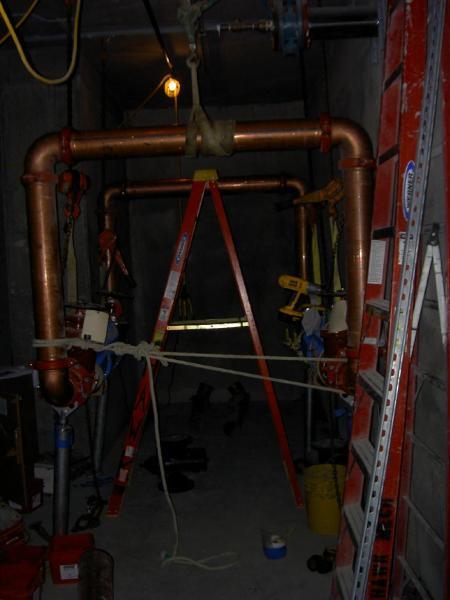

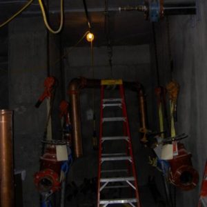

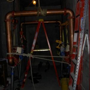

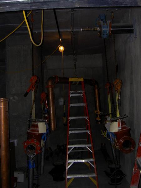

Well enough of that large bore copper med gas crap, in tight locations.
Just started the double 6″ backflow preventers for the main water entry for our 10 story hospital.
Water main comes in over head ( 6″ ductile iron) it has the blue valve on it.
There were some 3/8″ inserts in the concrete that I used to bolt the unistrut to the ceiling so I could hook up my chain falls—— there is 4—- yes only 4, 3/8″ cap screws holding this whole mess up, it keeps people away from my area & bothering me when I tell them—- “wow I can’t believe the strength of just 4 3/8″ cap screws.”
Here’s a couple of pics—- sorry for the darkness, it was a borrowed camera.

    you can lighten those pics in Irfanview by sliding the 'gamma correction' tab after clicking the 'enhance colors' window in the scroll down menu under 'Image'.

    wow that copper around here would require an armed guard 24/7...
    quick question...  I've got what looks like the exact same backflow preventor on my lofts... cept 3"   feeds from a 3" galv pipe ... then feeds a manifold that feeds three 1.5" lines...
    the valve on each side of the backflow preventor has a 4 hole flange... is it best to just use a threaded flange to adapt this to my 3" pipe  or do i need something with a little "give" ?

      Once assembled ours have no give at all, & are braced every way from Sunday.
      Threaded on that size gets a bit tricky for those that don't do it all the time. Grooved vic piping is less mistake prone, cause there is no make up in the fittings.
      Vic is loose until it's assembled then it's tight & doesn't flex.
      Vic is not hard to do, but it is hard to aquire the machine to do the work, but you can buy prefabbed pieces from most fire protection shops.
      That 6" copper is in the basement, & there is a guard 24/7 outside the new hospital.
