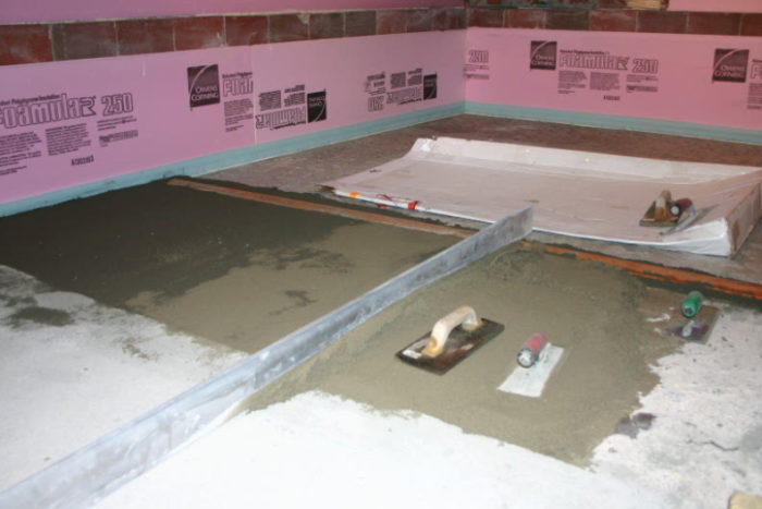

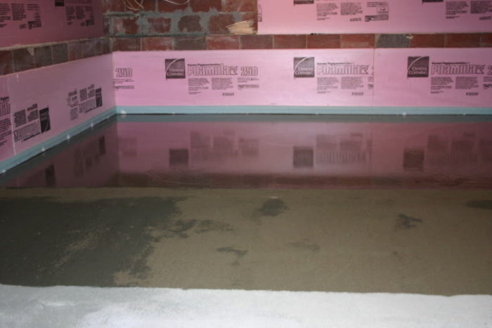

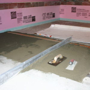

    You don't want to use self leveling cement to fill in 4 inches, and you can't use it if you need slope for a drain.
    If you want to "level-up" the floor and build in a slight slope for a drain you should use cemet-based "mud," just as they do for shower pans.  Get some helpers to carry bags of premixed sand/mud mix or make your own using sand and cement.  You can mix it in your basement and adjust for flat/level/slope using screeds.
    See the two pics below -- one using mud mix to level a basement floor, and then using self-leveling cement on the end to fill in the last 1/2 inch o depth, which is too thin for mud mix.

          In this context mud is not slang for concrete.  Mud is mixed very dry and it will not slump.  Most (but not all) concrete is very wet and will tend to seek its own level before it starts to cure.
          See this article about building a shower pre-slope using mud.  The same basic technique can be used for leveling a floor.  If the mud is going over existing concrete, then a slurry of thinset should be used to bond the mud to the concrete:
          http://www.ontariotile.com/preslope.html

    See the two pictures below -- one using mud mix and a metal screed to level a basement floor, and the other photo using self-leveling cement at one end of the floor to fill in the last 1/2 inch of depth, which is too thin for mud mix.
