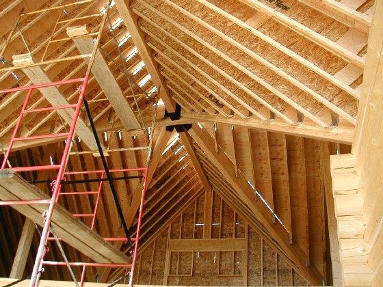

    We are building what seems to be Le Chateaux Glulam. What I mean by that is that we have a lot of glulam beams in our house for the very reason you mentioned: to eliminate visible posts.
    Our beams get supported in multiple ways:
    o Some rest on 2x posts concealed in frame walls
    o One glulam meets another glulam via a concealed bracket hidden in the connection. This was suppossed to be a simpson bracket, but my husband hates visible fasteners in addition to visible posts. So, he came up with the idea for the concealed fastener and had it blessed by our structural engineer He had it fabricated somewhere.
    o We have another form of fastener where log joists meet a glulam that were also designed by my husband and blessed by our structural engineer...again, to eliminate visible fasteners

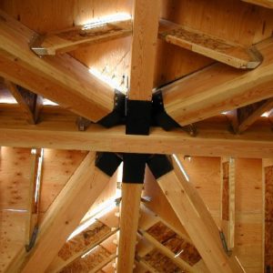

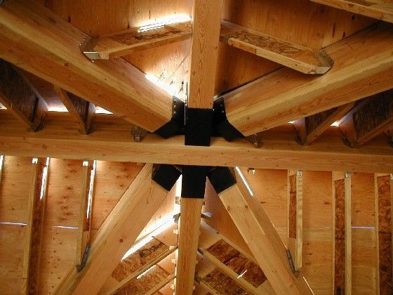

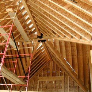

    o and then there is a granddaddy of all: Where 7 glulams come together at the peak of our roof. This bracket was designed by our structural engineer specifically for our house and welded up by a welder. Here the visible fastener was unavoidable, but its pretty cool looking. (See pictures below).
    One thing I should note is that we didn't do any of this stuff without our engineer's blessing, but our house is a pretty complicated system with high snowloads. The point of this post is that there are many ways to do this, just make sure it is sound. I think getting rid of posts is normally a good idea....but I might have been brainwashed by my husband. We're starting a "no post, no exposed fastener" religious cult soon! LOL!

      I'm not sure if it's my browser or not, but the photos didn't come through, and after your buildup, I'd really like to see them.  Any chance of reposting?

      1. Paularado | Jul 23, 2003 06:44pm | #9
        Hey Nick,
        This time I attached them. See if that works better for you

          Thanks for posting the pics.  Piffin was right, the originals came thru after rebooting.
          Hats off to your husband and everyone else involved in the design.  Impressive.
