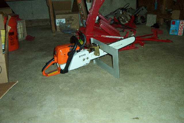

View ImageView Image
that looks way to clean to belong to a framer
<G>
She was brand new that night.... cherry still intact. Ugly all clean like that isn't it?View Image
throw some dirt on that sucker- get it broken in quick
looks like a cool tool, but I don't think I'd have much use for one
