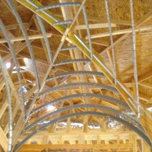

we have started making our groin frames from 3/4″ osb and running a slot cutter along the bottom edge of the frame. This makes it easy to trim the drywall to the frame, simply hang drywall on frame and then run rotozip down the slot in the groin for a perfect trim job.
  1. brisketbean | Jan 29, 2008 07:11am | #1
    sorry about the picture, the slot in the bottom of the groin isnt visible, but it is there, need to fire the photographer (wannabee)
    1. LIVEONSAWDUST | Jan 29, 2008 07:15am | #2
      Cool !   How are you forming the curved steel joists ?
      1. brisketbean | Jan 29, 2008 07:24am | #3
        with a radius track, track and stud bender.
        1. LIVEONSAWDUST | Jan 29, 2008 07:40am | #4
          I'm not familiar with those terms, can you tell me more?
          1. brisketbean | Jan 29, 2008 08:03am | #5
            http://www.radiustrack.com/track_bender.aspCheck out this url, it is a great tool, i have had mine for about 4 years, it cost me a little over 4 grand but has paid for itself many times over.

    Nice work as always.  If I understand you correctly, the bearing on the Rotozip fits into the slot and then you get a perfect "valley" line?

    1. brisketbean | Jan 30, 2008 03:46am | #11
      yes that is right tim, it works great, i just routed out about a 3/16" slot with a router before putting the groins up, it was the easiest valley trim ever.
