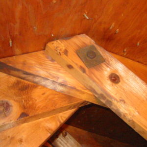

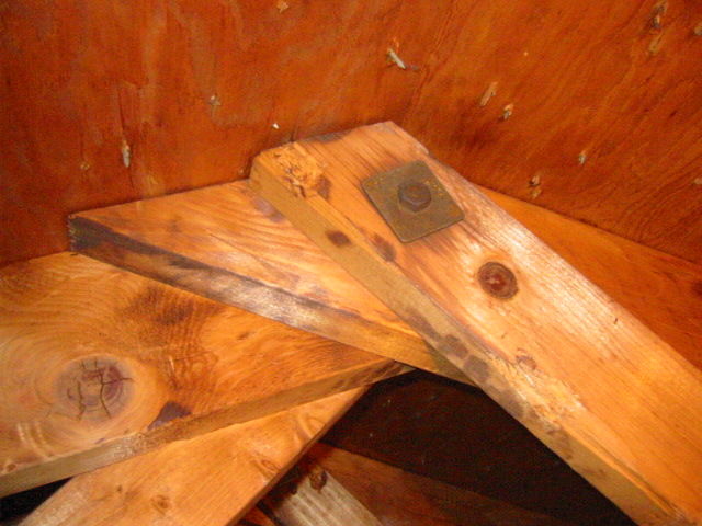

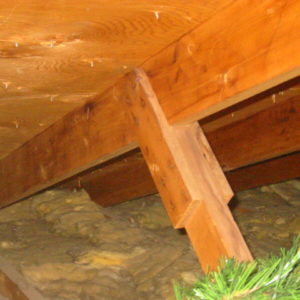

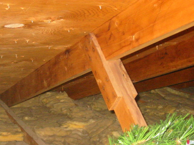

I though you might be interested in this truss I saw today – 42 year old ranch

    Did you take those because you thought I'd be interested in seeing them, or to poke fun at me???
    I'd say they're typical of what I've seen in homemade trusses - Completely inadequate connections.
    Nostalgia isn't what it used to be.
      rjw | Apr 05, 2003 02:55pm | #2
      Thought you'd be interested - not poke fun.
      Most homemade trusses I see (and I see a lot in inexpensive ranches from the 50's and 60's) use plywood gussets, like where the web pieces connect; I'd never seen one bolted at the peak before, though.

        So is that greenery in the attic a Holiday wreath, or bushes growing as a result of roof failure?  :-)
  2. migraine | Apr 05, 2003 11:20pm | #4
    So that's where everyone keeps their artifical Christmas tree :-)
