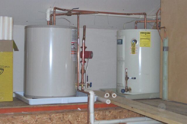

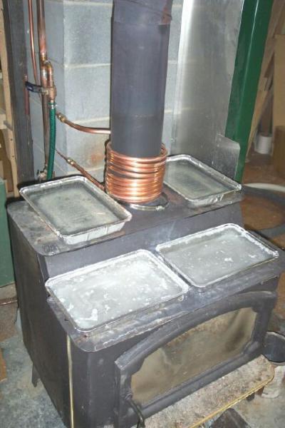

I just finished a preheater for my domestic hot water tank, wrapped a copper coil around the stack of my shop stove, covered it with a shield and ran a line to a second 40 gal water heater hooked in series with the main tank. Used a 1/25 hp pump to circulate the water, pump is hooked to a thermostat shuts off when the stack gets below 100 degrees. Only had it a few days but it maintains the water temp in the tank at 90 degrees with the stove burning part time. For the summer I plan on doing something with solar to help take the edge off the 42 degree well water temp. Pans on the stove are not soup they help add humidity to the shop.

Nice work as usual. Not as pretty as the stairs... but I can appreciate the setup.
I'm curious on the right hand tank, at the bottom by the drain valve, what is the stub coming up w/ the ball valve for?
-Erik
Stray,
The right hand tank is the main tank, the stub in question is for a circulating branch line running to the kitchen. The kitchen sink is the longest run in the house and with the water saver faucet it takes forever to get hot water down at the far end of the building. When I redid the plumbing to accommodate the preheater tank I installed a 1/4 in copper line along side the kitchen run stopping just short of the sink and insulated the heck out of them. I plan on hooking a circulating pump to the tank operated by a timer so it only runs during the normal use hours. In essence this is an extension of the hot water tank since the line has a greater R factor than the tank itself. This concept is commenly used in motels and such where lines are 100's of feet long, this is new to me so I'll be interested to see how well it works in a residential application.
