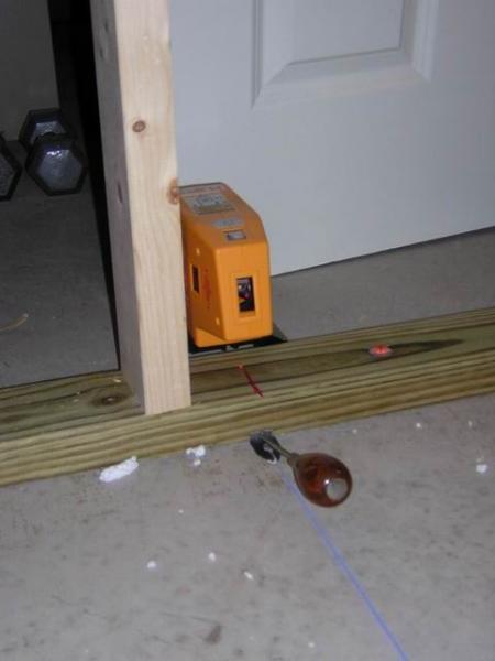

            To mark out where the front wall of the office will land, I borrowed a laser line from one of fellow eds (Thanks Chris), then used a chalk line to duplicate where the laser fell...
            View ImageJustin Fink - FHB Editorial

          15. calvin | Oct 12, 2006 12:06am | #30
            Here's one for you justin.
            I cannot remember if you were drywalling the ceiling (as this step is a good one for those using drop ceilings) but I use this procedure on all jobs and come time for tile (floor or ceiling) I'm always glad I did.
            I start the job with two control lines and build off of them.  They are square to each other.  They may be in a corner a foot or two off the ext. wall or right smack dab in the middle of the building area.  Think about where you want them and won't cover them with walls/material or whatever.  I'll often plan according to a known opening and run one through there to be able to get at it after walls are up.   All walls, soffits, cabinet runs.......everything are pulled off these two lines.
            To keep the chalked lines in place for the duration I spray clear lacquer or any clear non waterbased sealer over them.  Of course you wouldn't do this to a finished floor, but on a sub or bsmnt concrete that'll be covered later, it's the #### 's.A great place for Information, Comraderie, and a sucker punch.
            Quittin' Time
          16. FHB Editor
            JFink | Oct 13, 2006 12:26am | #37
            I did something very similar in this job Calvin - squared up the wall under the load bearing beam first, then worked my way off of that. Your idea of lacquer over the chalk line is interesting, but why not just use permanent red chalk instead?Justin Fink - FHB Editorial

          17. calvin | Oct 13, 2006 12:56am | #41
            Unless I used an ink line I don't think the red chalk, tho permanent, stays crisp as I would like.  That's all.A great place for Information, Comraderie, and a sucker punch.

            Remember that chalkline from the previous post? Well that line became the front wall (and rough opening) for the french door to the office area - as seen here:
            Notice that I didn't put in the cripples above the door yet, that's because I couldn't raise the complete wall without that copper pipe getting in the way... Next pic shows how I built the crips to go around the pipe -View Image
