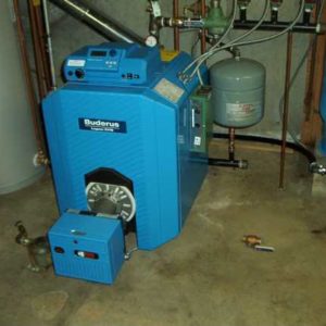

      dieselpig | Feb 28, 2006 09:31pm | #19
      I like it just cuz it's so darn cute......
      View ImageView Image
