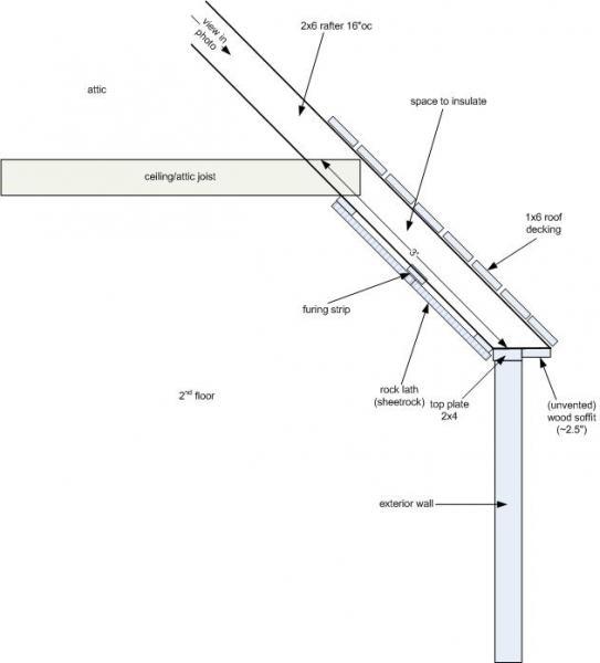

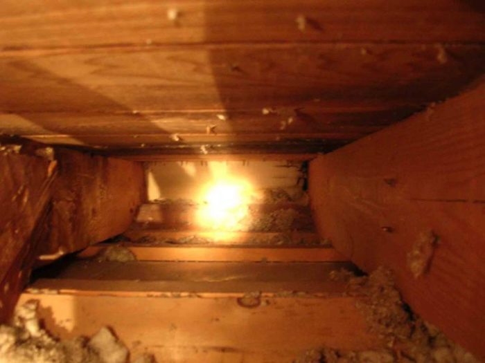

http://forums.taunton.com/tp-breaktime/messages?msg=60829.1 but the foam panels on the roof isn't going to work for a variety of reasons and I'm not sure the spray foam guys will be able to adequately fill these rafter bays without voids. Here's a (not too great) picture of the area in my roof I'm trying to insulate. Sorry about the flash spot, I can try and get a better one when I get home. This is the sloped part of the 2nd floor ceiling. The rafter's are 2x6s with furring strips and then rock lath for the sloped ceiling. The drawing should help. I'm in eastern massachusetts.I thought about fitting some polyiso pannels into the rafter spaces - maybe 3.5" total thickness, w/2" vent spacing (venting yet to be installed). For scale, this is about a 3' deep rafter bay, so I can't reach the bottom of it - but neither can a spray foamer. The plan might be to caulk the bottom edge of a polyiso panel and put it in the rafter bay so the caulk would seal to the top plate, 3' away. If air sealing the foam panel to the rafters is crucial I could use some squishy foam weathersripping or sill gasket on the sides. When I remove the soffit & fasica in the spring to allow for venting, I can confirm/fix the seal to the top plate. It would be a monsterous amount of work to do 50 rafter bays, but I don't think there's an alternative that doesn't have other problems/cost +$10k. Though I'm open to ideas.
