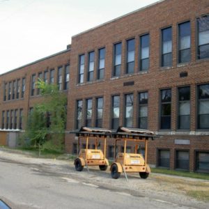

How elaborate would a wood shop have to be to build your own double hung windows?
I’m thinking of setting up a nice workshop and rebuilding all the windows in my school project. I have a couple of old original sashes available to copy. There is still one original window left over from 1926, the year that they built this building.
I need to make about 162 windows so I think I could afford to invest a couple of bucks into the equipment. I’ll also have about 5000 sf of work shop to work with but a portion of that will get some mechanical banks of meters and pipe running through it.
I’m thinking if Jim Blodgett can build them…I can. I’m pretty sure the first few of mine wont open but I have a fire bucket for the prototypes.

            This isn't a casement style job, unless we re invent the exterior, which we probably will do.
            Heres a shot of the windows.
            blue

          16. JohnSprung | Dec 15, 2006 11:01pm | #78
            Good!  If this is going to be condos, it really needs to look more warm and homey, and less institutional.
            -- J.S.
          17. blue_eyed_devil | Dec 16, 2006 08:08pm | #79
            That might a good observation or a bad one, depending on who's going to buy the units. If the locals step up and buy them, I won't need to de-institutionalize the building: they love it as it is. If I'm going to market to downstate empty nesters, I'll have to do a makeover.
            We'll be agonizing over this decision very soon.

    From the look of that building, my first question would be why double hung?   I think it would look a lot nicer with outswing casements.  Most of the time there'd be some open and some closed, which would tend to break up the huge monolithic flatness of it with some random detail.  Windows are just texture on a building that size.
    Casements, of course, are also a little easier to make, and especially to make weathertight.  If you start with outswing, you might later add inswing sash in the same jambs to get better thermal performance without double glazing.  That's been done throughout Northern Europe and Scandinavia for centuries.

    1. blue_eyed_devil | Dec 12, 2006 03:52am | #32
      Thanks for that site John.
      I was considering doing a historic renovation. The school originally had double hung windows and thats why I was considering making them.
      I like the idea of an inside casement. I'm going to look at that as an application that I might do here on my lake house.
