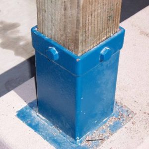

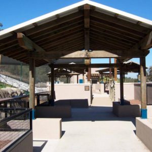

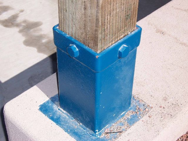

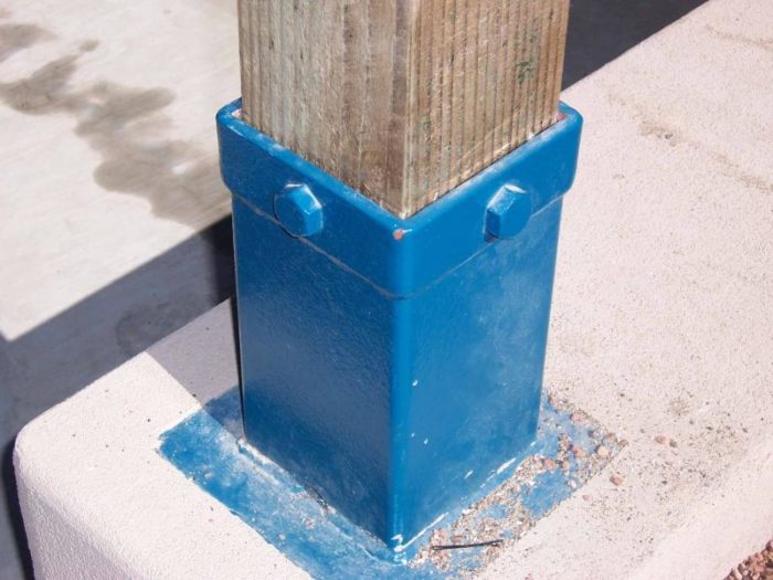

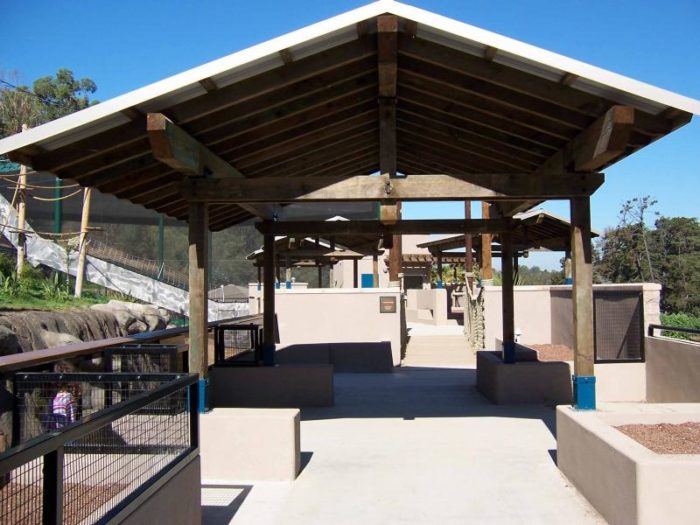

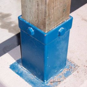

2) weld up some post bases that are essentially 6×6 square tube about 12 high with a metal plate on the bottom. The bottom plate would be anchored to concrete footings with all thread. The 6×6 posts would be bolted into the sleeves with lags. The nearby zoo built something exactly like this, but I cant figure out all the details.
See the attached photos for the Zoo design.
