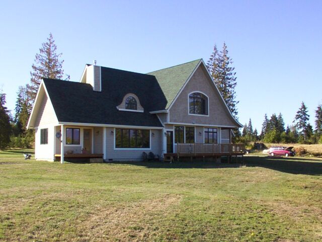

Here are some pictures of a house I just finished near Monroe, Washington – 40 miles Northeast of Seattle.

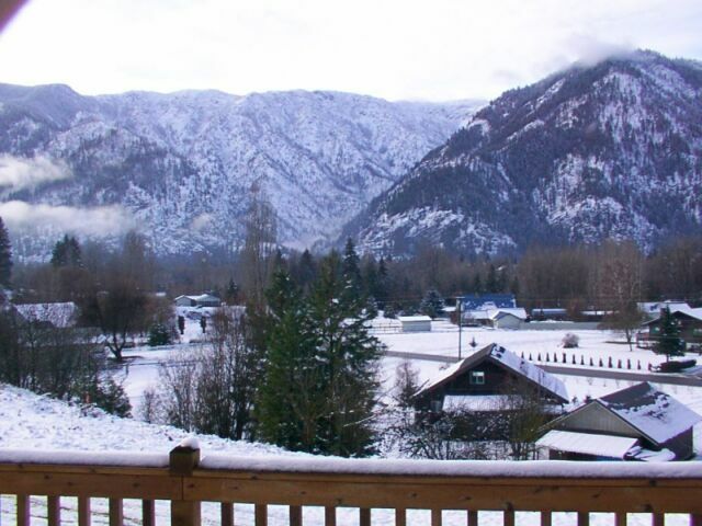

The first is of the view to the East, the mountain in the middle is Mt. Index, Luka lives at the base.
I started building February 2002.

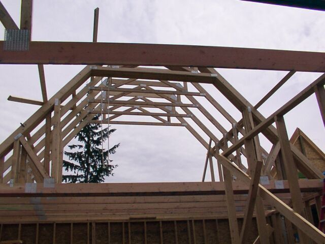

More framing pictures - I framed 95% of this house by myself.

Raising the gable walls was particularly hairy. Some of those rafters are 26 foot 2x12 Doug Fir, I stood on 2 stages of scaffolding and dragged them into place by myself. I also installed all the roof sheathing solo, but I did hire roofers to put on the shingles. I may be crazy but I ain't no fool.

Good eye Fortdh. The holddowns don't hold down the sill plate, they go up through the floor and through a bracket (simpson HD5A?) that bolts to a wall stud. In earthquake country, we have to use holddowns and shear wall nailing for any exterior wall without an uninterrupted 4 foot shear area...

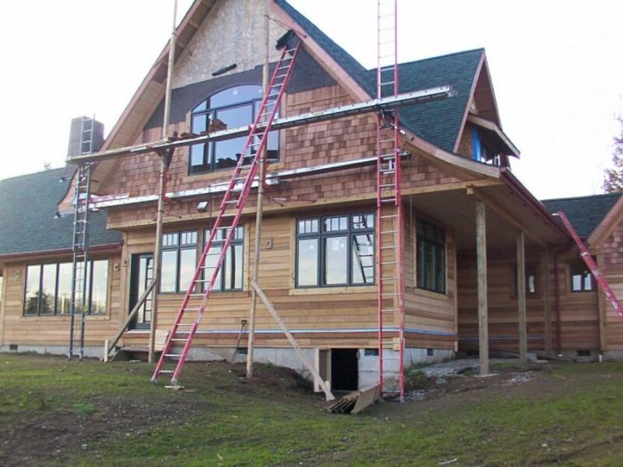

I did the wiring, plumbing and insulation. I subbed out the heating/ac. The windows are made by Lincoln (lincolnwindows.com). They are mostly casements with wood inside and extruded aluminum outside. I find them to be as good as Marvin - about 35% less $.
I used clear cedar siding and countless feet of 5/4" cedar fascia, window trim and banding. Tongue and groove pine for the soffits.

I know what you mean about the endless t&g, fascia, etc. etc. etc. It never ends, or so it seems. We rented a gradall forklift for awhile to access our high-up stuff....it was just too scary to be up there even on scaffolding for a couple of chickens like us.

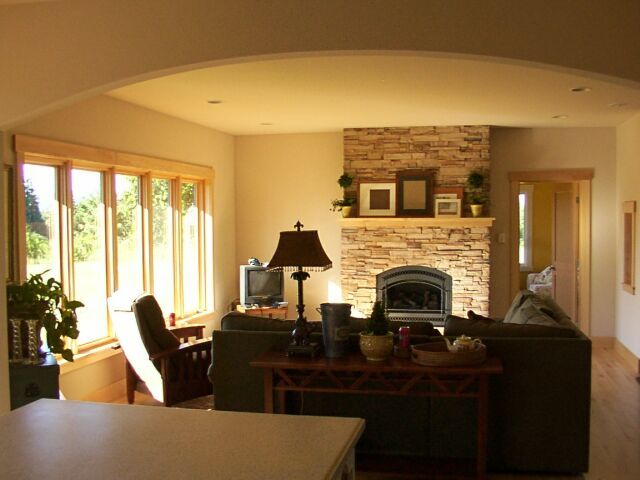

My wife and I did the fireplace brick. We used fir 2 panel interior doors downstairs. I trimmed out the downstairs with 5/4" and 4/4" maple. The downstairs floor is #2 maple. I got a great deal on the front door - display model - solid maple with walnut trim + a little stain glass
Fordth, I spaced out, its been a while since I framed the floor. The hold downs are simpson sstb's which hold down the sill with a nut/washer. Then a "long connector nut" is threaded onto the sstb - and a length of threaded rod extends up through the joist cavity through the floor above. These type of holddowns were spec'ed on the plans, so thats what I used. The framing inspector said I could have used the strap type holddowns, which go on the outside of the rim joist and are nailed into wall studs. These are MUCH cheaper and easier to install. Live and learn.
I've used I-beam roof rafters before, but for roofs with lots of dormers / cut outs / valleys they can be a pain. Much easier with dimensional.

The house I built before this is on the other side of the mountains from Luka, about the same distance. Check out this view........

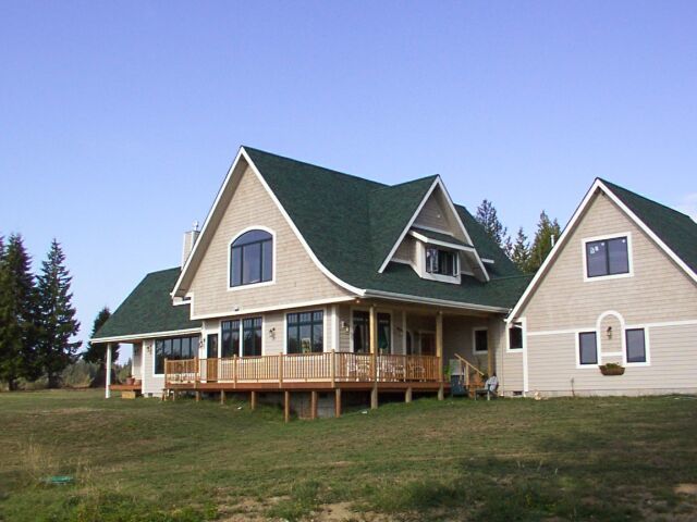

Here are some recent pictures of our house. I still have to finish out the decks, hoping to get the driveway and some sidewalks done in the next few weeks. The exterior paint colors aren't what I had in mind but I was overruled by the boss.
