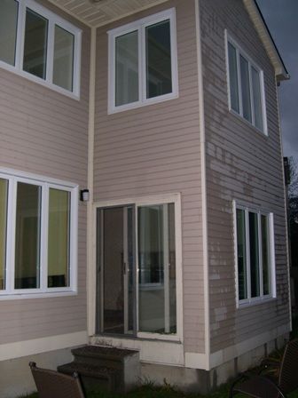

I need to replace the patio door to our backyard. I can’t decide if I should just put in another patio door of the same size or replace the whole thing with a French door with sidelight.
The problem I’m having with the patio door is that it doesn’t line up with the window on the second floor. I know it’s not a big problem but bad design choices like this just get under my skin.
If I replace it with a French door and sidelight, I would have to infill the resulting hole with plywood or something else until I redo the exterior sidiing. I don’t think I can find siding to match unless I take it from elsewhere on the house.
So what should I do ? Put in the French door I really want or just replace the patio door and get it over with ?
Other than look from the outside, does any one have other reason why I should go with one over the other ? One thing that comes to mind is the door swing for the French door. Anything else ?

The current door is 60"
The window above is 50"
My problem is not how to do it but rather deciding which one to do:
1. Replace with another 60" patio door and live with the fact that it won't line up with the window above. It bothers me everytime is sit in the backyard.
2. Replace with a 50" French door and side light and infill the remaining 10" with painted plywood or other exterior panelling. If i can't find a 50" unit, I have no problem making it myself. If and when I redo the exterior siding of the house, I'll then be able to cover that 10" infill to match.
#1 will be easier and faster. #2 will take longer, be more complicated, but will satisfy my visual senses.
If it were your house, which one would you do ?

Actually that was one of the options but there is a window on the side wall (about 12" away) and it partly be under the roof/awning. Running joke with my wife is that i'm buildng a two level deck with a door off of our bedroom. The door is where that second-storey window is now.
Move that chair from the picture..LOL I see you sit and stare at the problem ( or she does).

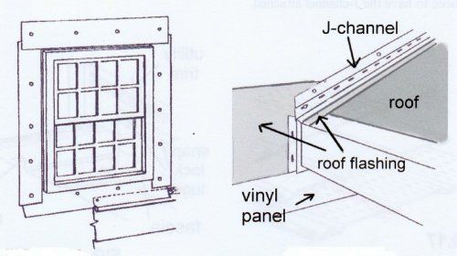

>>"In any case, I'm not convinced that the replacement vinyl windows were properly installed so i will want to remove the siding...."If they are in fact 'replacement' windows, then they now exist inside the frames/jambs of the old windows; and were installed without any need to flash them.
Politics is the antithesis of problem solving.
Old units were completely removed and new units put it place. All that was left when old ones were removed was the stud frame and header. New flashing on top and j-trim on sides. I'm fairly certain that some water is getting in between the siding and the tar paper if any water runs down the j-trim. I'm not sure where the is water supposed to go from there. but that's a discussion for another thread.
I know that this is how it should have been done. The flashing on the bottom should go over the nailing flange of the siding so that any water will drain from the weep holes on the siding or at the edge. Unfortunately, i don't know if it was originally installed that way.
How big is it now? 60"
12"36"12" or 42"16" or custom to whatever you want.
Put in a door, the same size as the window above.
Center it on the window.
Remove all the siding beside the door.
Now treat the wall completely differently.
Run trim all the way across the expanse at the top of the door, and cover the wall on both sides of the door with something different from the original siding.

The existing patio door is in the family room. If you take a look at the picture, the eat-in kitchen is just above that step. We have a table just in front of the window.
Your last paragraph is dead-on. The current door is too far from the kitchen and down a step so it is only used to go in the backyard. We rarely eat outside but probably would if we had a deck and easier access.
Building a deck, replacing the existing patio door with a window, and replacing the 3-unit window with French doors would be the best thing to do. We'd probably need a smaller table in the eat-in kitchen but that would force us to use the dining room more often.
The only reason I would not do this is because the 3-unit window was replaced just 4 years ago when i bought the house. The original wood windows were rotted through and i had to change some of them without knowing how we would use the space. If I take it out to put French doors, I can't use it elsewhere and I'm out $1500. Plus the cost of the new window and doors.

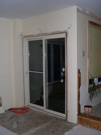

It's been almost one year since I asked this question. Finally finished replacing the door and window this week.
Went with a Andersen Frenchwood glider. It's a really nice door. Heavy as hell and a pain to install. It was my first time installing an exterior door. I used Blue Skin and tried to tuck it in behind the siding. Very hard to do since this stuff sticks to everything. Was working in the hot sun too so I getting impatient.
The window was easier to install. I will re-side the house eventually so I'm not too bothered with the painted wood panel under the window. I was able to salvage the horizontal siding from under the old window and reuse it on the left of the new. Unfortunately, I could not find a match in aluminum siding so I went with the wood for now. At least its the same color.
The landing and stairs are temporary. Next year I will build a deck, possibly with a pergola.
Almost ready to install the hardwood floor and finish this family room once and for all.
The flow to the outside has really improved with the new door location. I'm really glad I decided to move it.View ImageView ImageView Image

IMO your bigger visual problem is the top of the window to the left doesn't line up w/ the top of the door or the other window around to the side. The visual of the window above bothers me a lot less. While there are exceptions to the rule, yours doesn't appear to be one ... not sure why the window doesn't line up.
The hint by the one guy to change your finish material all around the door is a good one. Gives you a chance to flash it right, too.
What kind of siding do you have? Looks like you could find a match, but can't see the detail.
The tops don't line up because the door is in the sunken living room. That bothers me too but there is not much i can do about it. The pergola would fix that problem as well.
It is 23-year old aluminum siding with full-sun exposure. I would not even try finding a match. If i really had to, i'd remove the siding from the back of the garage wall (6 ft wide by 8 ft high) and then patch that wall with something new.
