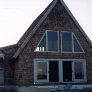

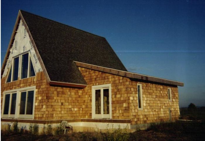

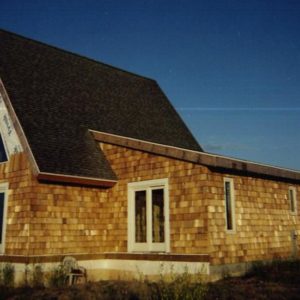

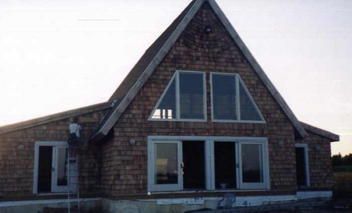

    I've got an IMT Paslode and found it the hot setup for the Cedar shakes. I put up 35 square on my place last summer. All those I handnailed with Galv handdipped were ok but the paslode was the hot setup. I used the galv ring shank 2" paslodes and it worked well.
    The only downside I found was the angle of attack with an IMT is a bit unusual. The closer the nail tray is to the nailed surface the more deeply the nail countersinks. Contrary the more you shoot on the toe the less deep the nail countersinks. Countersinking is bad on the shakes. They split if countersunk too deeply. Therefore you gotta stay on your "Toes" to keep from splitting the shakes. ;-)
    Another fun fact is how to hang them fast. I made a 1x8x10' with a furring strip nailed on the bottom so it makes it a board with an "L" at the bottom. Then I glued & screwed 2 cheapie ($2.00) plastic levels to the side away from the lip. Then 2 - 3" roofing nails were nailed thru the same side near the ends.
    To use it This is how you get it going. With a helper I catch the lip under the last course, then level it by using the levels I glued in place, finally tapping the roofing nails into the last completed row. The top of the 1x8 gives me a shelf to set the next layer of shakes on. My helper fills up my sack with shakes and feeds me nails and supplies (I use an old mail bag for the shakes which is the cats Aqq.) I can review the gap coverage then nail them in place with the Paslode. After the 10 foot is done I have my helper unnail his end and we either slide to the right or jog it up to do the next row. Repeat until you can't stand it anymore.
    You've done it before so I hesitate to describe the right leaning and left leaning shakes. Damn few straight. If you bring a utility knife with you in your mail pouch, you can shave the rights to straight etc.
    Of course length is all when you spec them out. 18 inchers are a royal pain. they seem almost barklike but the 24's seem like a vintage piece of lumber. Every other spec is the same except the length. Here is an attached pic of me in action on the shake attachment.
    Good luck

  6. booch | Mar 30, 2003 12:58am | #10
    Whoops wrong attachment.
    This is the one I wanted to attach. This attachment has poor resolution but if you see I have the tool in use. This is actually the 3rd one I made. When you get in close quarters you need a 4 footer rather than the 10 foot device.
