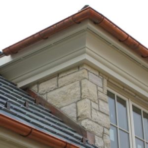

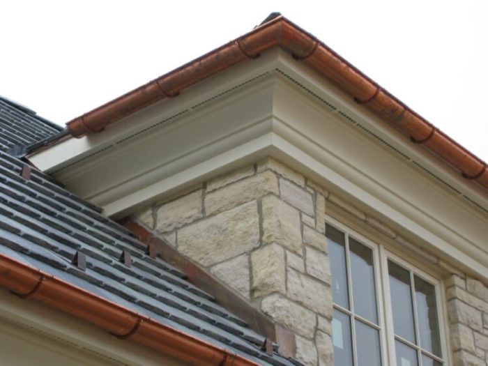

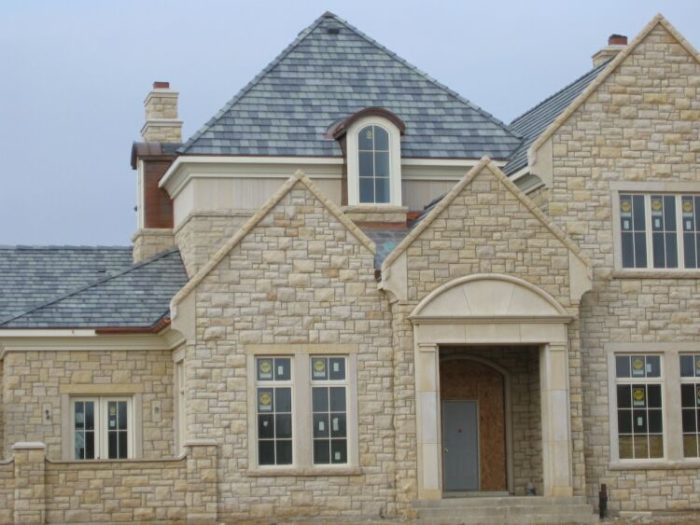

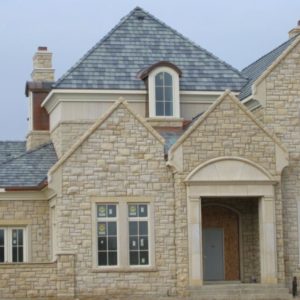

Here is a pic of some cement shingles, the company is out of Minn. can find out if your interested but seeings that your in California you probably can do better with a local company. They do look great and as the previous poster said, never have to go back up on the roof.
Sorry, I meant to add that the cement shingles are pricey and there is some prep work to be done before installing, I don't know what your area is so not trying to insult but there is a certain amount of technique to installing. Let me know if you want the manufacturers name.
