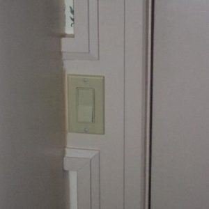

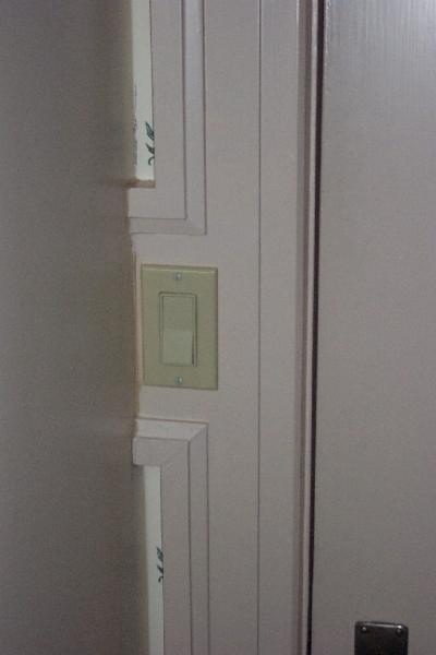

Here's another, and it's not the ideal but might look alright. I once had a switch box that couldn't move w/o a major wiring job. Was changing over door casing in a period kitchen. The box was partly in the new wider trim line. I mitred out and around and back again to encompass the switch and coverplate. I'll try to find a picture and repost later.

Here's the trim, bumped out and around the switch. Remodeling Contractor just outside the Glass City.
