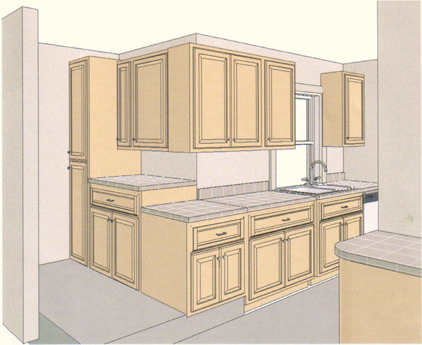

Chief is a great way to output 3D visuals for clients, I have the full version, luckily I didn't have to pay for it. In any case in about one to two hours I can go from having forgotten how to use the program to these types of drawings.
I'm not feeling too bad. I think I could do that in two hours or less! Bob's next test date: 12/10/07
When I first bought chief architect I figured I'd only be using the line drawing capabilities in order to create construction documents. I have to say that the 3D capabilities are what make the program though. It is really fun when you see your drawings come to life, almost like you're taking a photograph of what's in your mind's eye.
I'll post a couple of renderings of a house I'm planning on building. I finished these drawings a few days ago. There's a ton of time into them but like folks have said on here, simple stuff can be accomplished in a matter of minutes.
This really is a remarkable program, although it does have bugs, like I'm guessing most software does. The folks that write it do seem to be making an effort to improve it all the time, so I appreciate that.
