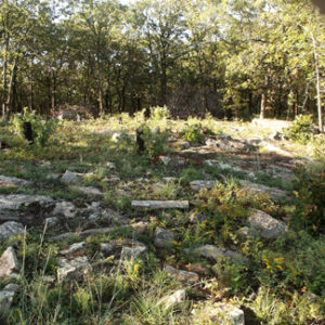

Im buying some land thats heavily covered.
Im going to hire a dozer as its the only way with this deal.
After its done there will be many of the roots that made this mess to begin with.
Ive heard diffferent versions of the solution to the dilemma.
One a sub soiler that rips the roots from the ground but only the big ones?
Two a spray a weed killer on the shoots a coulple to three times and disk it .
Then plant grass to starve it out and fertilizers . Mowing will keep it down if it comes up.
Whats says the jury?

From the pictures it looks like the land is pretty steep. If all you are trying to achieve is a view, why not just have a local come in and log it? I agree with the others, a track hoe is the way to strip the land clean, and to remove trees root ball and all, but with winter coming I'd be worried about errosion, maybe even washing out the road, if it were torn up track hoe style.

I didnt mention it but yes its pretty steep. The bottom[below the road] doesnt really have anything worth keeping other than firewood and its too much trouble getting it out. We are blessed around here with firewood so theres not much sense in pulling it out of steep places to get it .
The land goes to the bottom of a holler and I have no problem with a dozer pushing it down as far as he can operate and leave it .
The erosion part is why I wanted to plant fesque grass which is wild game grass here . It doesnt grow very high and doesnt really need to be mowed with game animals eating it . It makes good hay for then in winter.

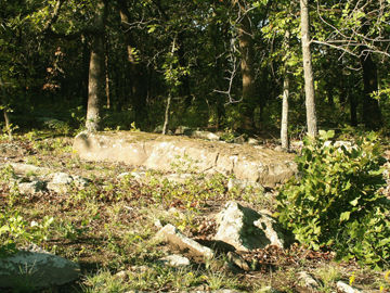

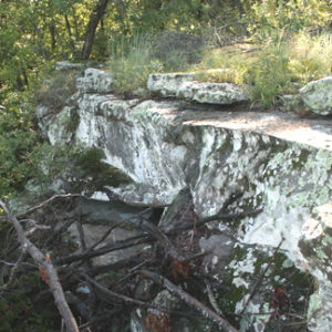

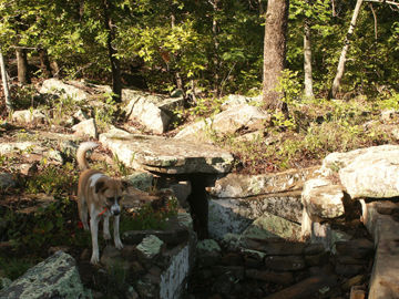

Feel lucky you only have to deal with trees. Here are the rocks & trees I have coming to deal with in Tulsa area.
The Tulsa skyline is 20mi, this is 3-400 ft above the Arkansas river. Some of these stones are about 5 ton. The solid ledge is 40-50' deep.

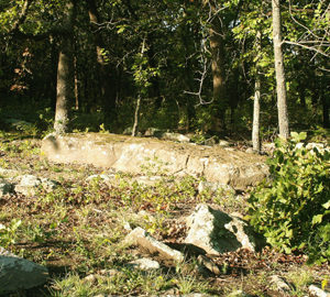

Plan on building a pumped waterfall in the natural break by the dog. The stone block forming it is 20'x15'x30'+ deep. Figure it has been in that position about 200,000 yr so won't go anywhere soon.
The underlying rock formation is 200 million yrs old.

LOL, I could show you similar pics .
To the back of the property there is larger rocks than you show . To the front of the lot are just a lot of building rock but their are many.
Ive got a small bluff like that going into the holler , but its too far down there for me to care. Machinery will never see it , its so steep getting to it .

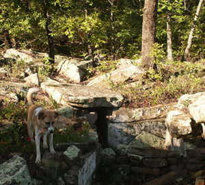

Thanks for sharin the pic. You gonna build your house there ?

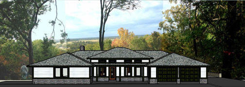

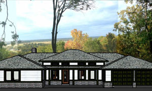

This is house to go there it's an Autocad model with Sketchup materials pasted on and real pix as the background.
This rock DW calls the Manatee is 14'x6'x3'. I'm going to build up next to it but save it.If you have a problem, don't just talk do something to set it right.

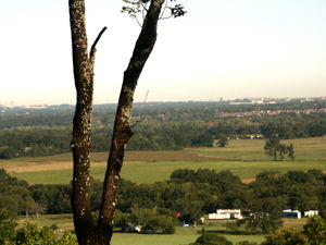

Pic 10 and 3 represents what I need done.
In what ever pic it is TJ is looking at the upper land that is the building land. Everything below the road goes bye bye.
I just wish it had been a clear day. Those are mountains across the river that look like humps.
