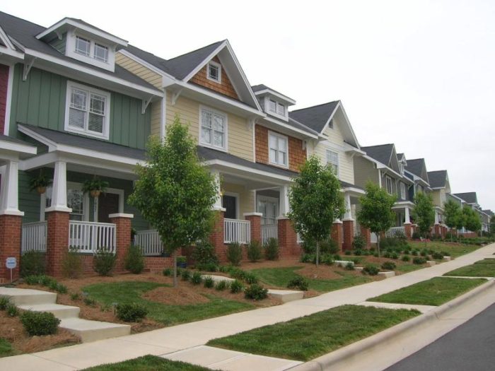

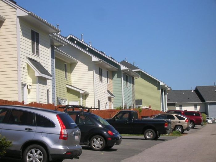

Attached is a few pics of the type of look we are going for. Hope the sizes come out OK.

Scott's Mill ?
Yes - we want that type of look, but our sales people say different floorplans would sell better. Also, we want to have a little more varied product offering.
I dont have any great input, I just recognized those townhomes. If you dont mind, who is the builder you work with? Preservation Homes?
