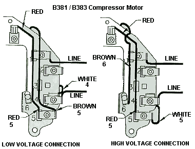

I have a speedair 3 HP compressor with a Century motor.  I need to change the voltage over and the diagram is missing. I wondered if anyone had one like it and could email a diagram to switch the voltage from 220 to 110. I tried customer service but nobody could help.
  1. RalphWicklund | Jan 12, 2004 08:19am | #1
    Is this the motor you have?
