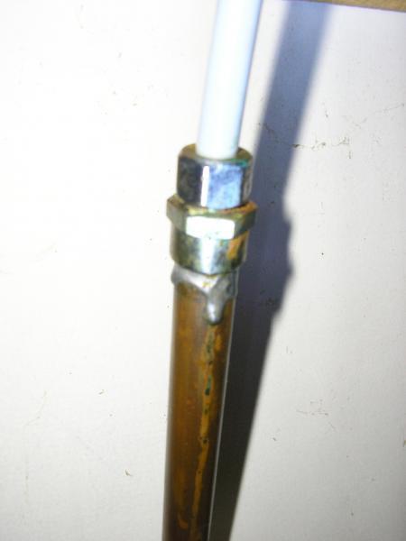

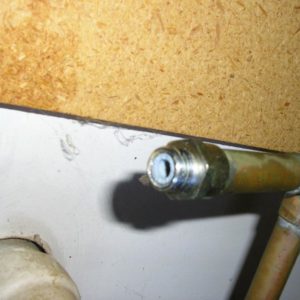

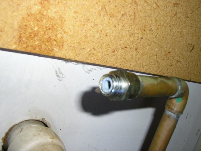

I was able to loosen the nuts on the grey supply line both at the faucet end and at the copper line below, but the grey flex line didn’t even budge when I tried to pull it out from the copper end. It ended up snapping off (see photo). Now I’m not sure at all about how to get that line disconnected in order to put a new one in.
The flex supply line definitely had to be replaced as the pinhole just kept getting larger. But after the line snapped off at the connection I was screwed because the shut off below it is frozen in the on position. I couldn’t even turn the water on for even a short period anymore. I ended up capping the connection cutting the cold water to that faucet, but at least now I can keep the water on for the rest of the house, without shutting it off.
My question now is: how in the world does that connection work and will I end up having to cut it off the copper pipe in order to eventually attach a new supply line and a new faucet?
If you look at the photo you can see there is still some of the flex line remaining inside the connection.

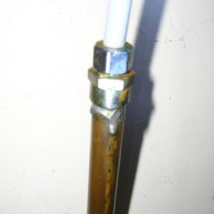

I also included a photo of the hot water connection to show what it looked like before it snapped off.

    It's a compression fitting.There is a ferrule on the tubing above where it broke off.  Anyway, you will have to remove the piece of tubing that is stuck in the fitting.  Use a knife with a small blade to whittle it out, or drill with a 1/16 drill bit to split the tubing in two.  Make sure to use a new ferrule on the new tube.
    Like I said, you should have cut it where the leak is and used a coupler to fix it, less trouble.
    I suspect this is polybutelene tubing on the hot side.  That stuff is prone to become hard and brittle, and even faster when heated.  A coupler may have been futile too.

    It's a standard compression fitting, and the plastic pipe welded itself in there over time.  You don't HAVE to remove it if you use a braided hose to replace it, as the hose end has its own rubber gasket that mates with the fitting without needing to fit inside.
    But it's probably best to remove it.  I'd just use a drill bit a little smaller than the outer diameter of the tubing.  Drill slowly at low speed, and the bit will likely "catch" the tubing about halfway through and pull it out.

        What holds the tube you have into the fitting is a nut and a ferrule.  The ferrule is a ring that goes on the tube, it's tapered on the edges.  When you tighten the nut it squeezes the ferrule  tightly to the tube and wedges against the fitting.  You only tighten it snug, overtightening will cause it to leak.  You can't ordinarily reuse the ferrule, and it should be a plastic one for plastic tubing, or brass for metal tubing.

    I tried to get that tubing out, but it's seemingly impossible.
    It's also preventing a the new supply line to the faucet from being attached because the tubing occupies space the new connector needs (it's not able to screw on).
    Is there some sort of adapter that I can put on here that will allow me to use a standard compression line?
    The faucet is 1/2", and this vile supply end connector is 3/8".

    I ended up digging out the siezed up plastic lines that were stuck inside the fittings by using a small screwdriver and just prying it out. That way I just needed two hoses.
