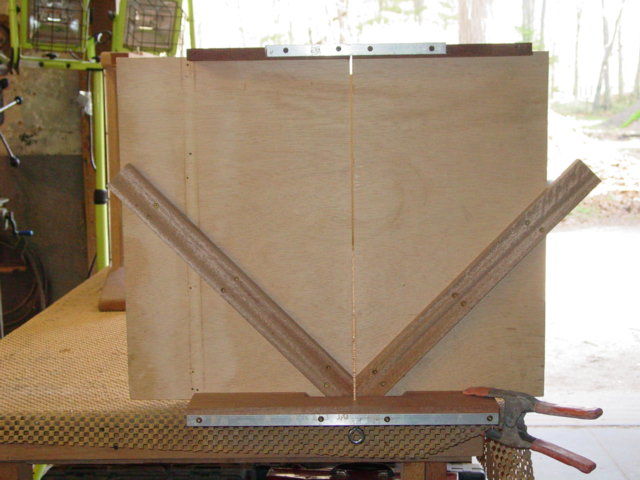

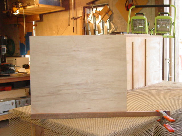

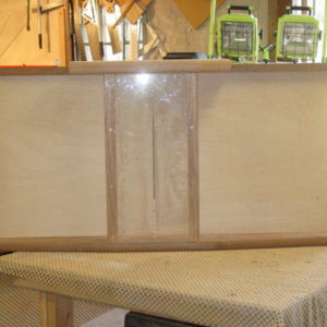

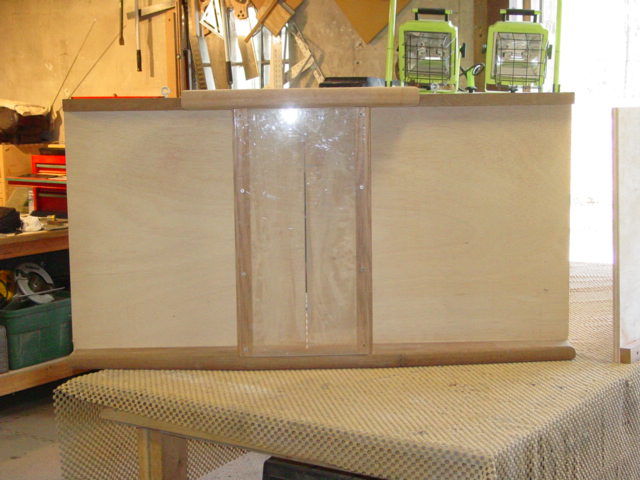

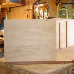

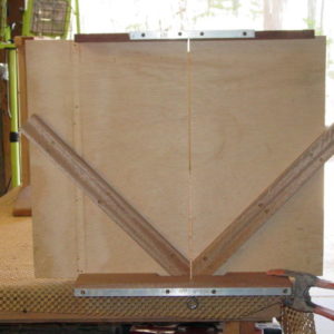

          2. alias | Apr 21, 2006 12:49am | #9
            here are those fences........... have fun. slainte'.." we judge ourselves by our motives, and others by their actions........."
