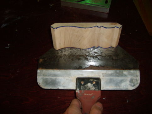

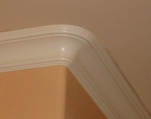

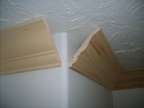

I’m putting crown around 6 bullnosed outside corners and decided to try the “wire lath and plaster, radiused crown, method.”
Here is the pic I lifted from JLC and a few of the first steps I took today. The crown is 6-1/2″, so I doweled the corner and doubled the wire lath.
Tonight I grind a knife and tomorrow I’ll try the first coat of 210 minute mud.
Brian,
Is the first pic the finished product or the objective?
'At any rate, I have rebuilt some gold leaf plaster frames in the past and would be eager to learn a new technique.
You post some great projects. Most folks have no idea the effort and time it takes to document a procedure and results.
Thanx for sharing.
Chuck S
Chuck,The first pic is the goal...I hope mine turns out that well.Strange and wonderful projects do sometimes find me. Always glad to share the wealth.Stay tuned...Cheers,Brian

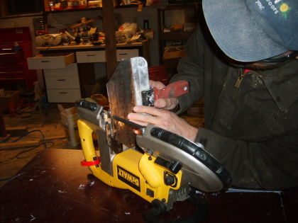

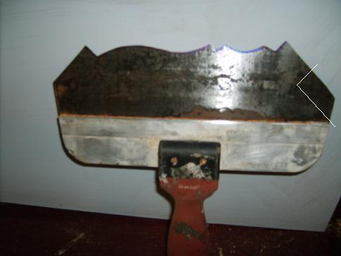

How are you making the knife? Bench grinder?
I've seen them repairing cornice like that on TOH. Looks pretty cool. I'd like to try that.
I roughed out the shape with a portable bandsaw, then worked the profile on the bench grinder and touched it up with a dremel tool.Now I'm ready for work tomorrow.
Great idea to use a drywall knife for this. the built-in handle will help.
If you do use a template, you might want to cut a bit of the blade so that it registers against the template. and use a smooth piece of wood like hardboard or baltic-birch plywood. you want something that won't snag.
..and dont use plaster of paris...it sets too quickly...much to my dismay. I knew it would set up quickly but i didn't account for my inexperience.
Nice job on the knife. Good Luck.

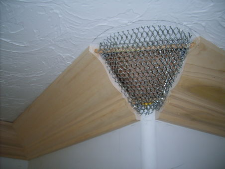

Thanks,All went well today. Put in 240' of the 6-1/2" crown and did the first coat on the outside corners.Tomorrow I will sand and recoat, among other things.Cheers,Brian
I'm thinking you might want to seal that end grain with Durham's or Plaster Weld before you mud.

The 210 mud worked well, as luck would have it.I ran two screws through the wire lath and into the crown on each side (the wire lath is also stapled onto the crown). I also gave the end-grain a good primer coat. These corners are on very short runs of crown (1-2' max) and are secured well at the outside corners and the joints at the other end of each piece are coped and can move (to help the plastered corners live a low stress life).
How thick did you mix it? Any additives? Did you have any problems with sagging? Did you just run the knife at 90° and follow the corner around? How many coats did it take? Could we see a close-up pic of that corner?... Oh, and why is the sky blue?
I know that's a lot of questions, but it's the part of the process that I was the most curious about. I have had very limited success whenever I try to shape compound with a knife.
No Additives and a stiff mix, no sagging issues...think the double layered wire lath really helped grab and hold the mud. If I was just placing mud in an overhead void--I don't think it would hang in there.The knife followed the curved guide I screwed to the ceiling and the wall (with a light touch--just grazing the guide surface and moving as smoothly as possible--the motion is a combination of frosting a cake and defusing a bomb).Close up to follow,Bass

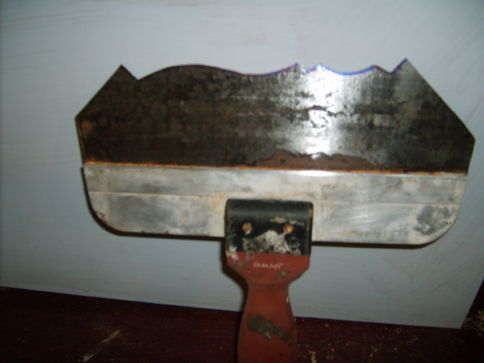

Here is a pic of the knife in action:
Looks good Brian. Don't do so much finish carpentry now- mostly stair work, but if I do I'll certainly ask about how you made that knife.Keith

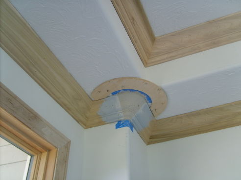

It was mentioned to use a temporary template on the ceiling, dumb question but how is it temporary?I love tackling projects like this as well, most of the time the boss is the one to instigate such projects, so he dosen't mind the labour.
temporary if you use a template on the outside of the crown.
In the pic, they use what will obviously be a permanent template :-) Nothing wrong with that either. Probably even better.
Here is the template, the painter will just have a few small screw hole to fill:

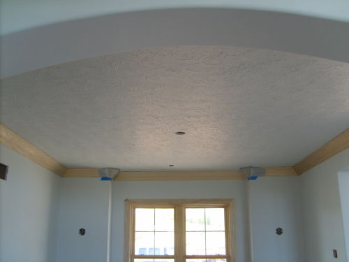

we're all cheering for you. is it possible that in the "finished" photograph the radiused outside corner was a pre-fabricated component,similar to the pre-fab outside corners available for the home handyman?
also-I have serious concerns that you are going to have a persistent crack where the flat stock meets the curve.
PS- consider BONDO- apply it in thin multiple coats as the foundation,use Durham water putty as the finish coat ( careful-swells slightly and is tough to sand) touch up with spackle.
Good luck!

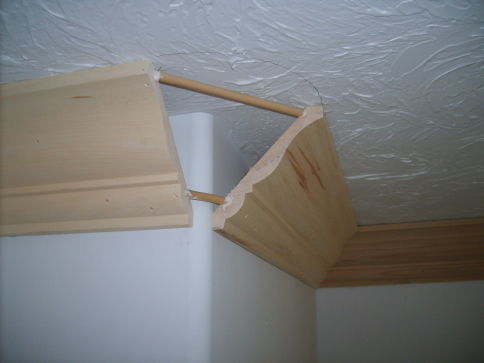

Here are the other thumbnail photos of the process, as posted at JLC:I added the doweling step and doubled the wire lath to help prevent cracking on the wood to plaster joint.Gotta get to work,Bass
if you look closely at thumb_crown1.jpg, i think it looks like there is a radiused template for the blade to rest against.

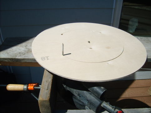

Here is the curved jig I made, it worked pretty well:
I like that method of circle cutting. I'm pretty good at figuring out unconventional ways of doing things but that is simply genious.--------------------------------------------------------

Thanks.It did make short work of cutting perfect circles. Necessity is a mother!
Your circle-cutting setup looks like a scene from an old Tom & Jerry cartoon.

As Julian mentioned, I'd be concerned about the plaster/wood joint cracking. I agree that it would be a good idea to drill and epoxy some dowels or something into the end grain of the wood. Better yet, screws would provide much better anchoring as the plaster forms around the screw heads. I'd still drill and set them in epoxy, as driving the screws may split the wood.
Whatever the case, I wouldn't do this without some sort of mechanical method to tie the different materials together. --------------------------------------------------------
Cheap Tools at MyToolbox.netSee some of my work at AWorkOfWood.com
Ted,There is plenty holding the corners together...they are doweled with glue and pins through the crown and dowels, the doubled layers of wire lath are stapled to the crown, and to the dowels and the lath is screwed to the crown too.I don't expect major issues with cracking...time will tell.
Here is a photo that shows how short these pieces of crown are (that and with the doweling and doubled wire lath stapled and screwed to the crown)--stresses on these corners will be mitigated--I hope:
