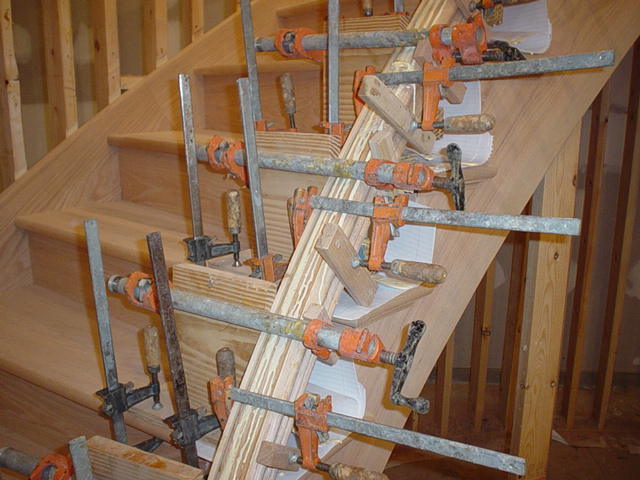

This is a rail I just glued up today on the curved stairway I just posted.
Man those stairs gots to be expensive with all the labor that goes into them, from mocking up the walls, the laminating, glue up etc..
How much spring back will that have once you release the clamps if any at all?
CAG: I have a little springback..not much...but it is already built into the jigs clamped on the treads. I am happy if the rail stays within a 1/4 inch of the planned centerline.

A man with pipe clamps is good to know. Nice work.

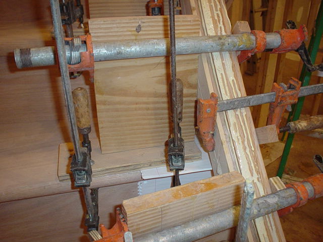

Stan,
Either you had several extra pairs of hands or you used a glue with a long open time. Which is it ? Or is it both? I like your setup with the "legs" fastened to the treads. Nice job.
Mark
professor: I usually have someone such as my wife glue the rails up...but actually I did this rail solo yesterday. I have about 45 minutes and I did struggle with the laminates on this one...but FINALLY got them to behave..
Stan,
What did you use to give you 45 minutes, sure couldn't get that long with titebond.
Mark
Mark: It was titebond....but I dont have my glue up room very warm to buy me time. In the summer I have to work faster..but usually can get one all clamped up in 30 minutes even with a lot of trouble.

Armin: I intend on trying unibond. I have had no problems at all with titebond. However...Titebond 11 does set too fast. I do have to overcorrect just a little for springback.
Stan...Titebond makes Extend which they claim resists creep better and has a longer open time. It has a self life about it that isn't on the container. Seems to work.
Edited 3/15/2003 10:17:33 PM ET by arcwood
Arcwodd: Thanks...I have heard about Extend..but I havent really pursued trying any other glue...because I just have never had any problems with titebond.
Stan,
For the benefit of the newbees I'll add my two cents at this point. I used to use titebond for laminating curved railings. Built about ten sets of stairs and then one day I glued up a handrail. After two days drying time I was ready to shape the profile. The router bit snagged a section of cross grain and pealed a piece off about 6 inches long. I couldn't believe it, next I worked a screwdriver into another ply and was able to peal a foot off like pealing a banana. It wasn't a total failure but enough of it came off to make me a tad uncomfortable. I called Franklin glue company and talked to the lead chemist. The first thing he said was titebond should not be used for stressed laminations and titebond 11 is an even worse choice. When I told him I had been using it for ten years and nothing like this ever happened before his comment was, Our test show that it has a 10% failure rate in high stress applications. Congratulations you just hit the not so lucky 10%. I talked with the chemist for the better part of an hour. Besides learning that titebond was a poor strength choice for what I was doing I also found out that the little telltale bump or ridge you feel at the glue joint will not occur with a resin catalyzed glue. I switched to Unibond 800 and not only have I never had a problem with cold creep but the quality of the glue joint is far better.
Whenever I do a handrail lamination I save the cutoff section, date it along with the customers name. The titebond sections all show the telltale glue bump over time. To some people it doesn't matter, and granted some clients don't know the difference. Some of my railings take the better part of a month to do, I like to think that 10 years down the road they will still feel smooth to the touch.
You really need to give this some thought. Titebond has a high water content, causing the fibers to swell, if you have a lamination 3/16 thick and coat both sides with the glue let it sit for a hour and put a moisture meter on it you will find the MC can go as high as 15%, take this times 10 or 15 plys and you have the composition of green lumber. This water has to go somewhere. On the plus side laminations coated with titebond will bend into a tighter radius simply because the wood fibers are more elastic. With unibond 800 the plys have to be thinner since no water is injected into the wood. I still use titebond for laminating narrow curved trim, as in the cove mold under the treads, the stress is not a factor and most people don't fondle the trim like they do the handrail, so the glue bump is not a consideration either.
Like everything else there is a learning curve to switching glue types, different clamping methods, longer dry time and temperature are a few things to consider. Titebond is the everything, every mans glue and in most cases it works ok, but it is not the industry first choice for laminations.
My purpose here is not to criticized how anyone does their work, but merely to point out that I have done the same with not so good results, besides I would like to think that after 35 years of building stairs I learned something of value, and would like to pass some of that info along, maybe help somebody avoid learning everything the hard way like I did.
Armin: Seriously..I take your advice well...ok? Maybe I have been lucky..I dont know. I just havent had any problems. I do always leave my rail glued up for a couple of days before releasing it. I will probably get around to trying some of that unibond soon.
