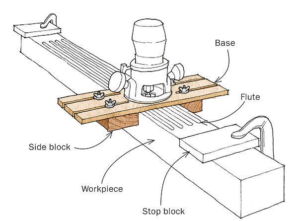

        Or, I had to do this before. I made a single pass jig and used a router with cove bit to reproduce for a match. I might still have the jig in the shop.....
  2. Graceconstruction | Feb 28, 2021 06:23pm | #4
    Fluted columns are easy to make. All you need is a router and a core box bit. Here’s a pic from Fine Woodworking.

  4. user-7670262 | Feb 28, 2021 07:12pm | #6
    Awesome. That’s what I needed guys. Thanks for the feedback everyone.
    1. calvin | Feb 28, 2021 08:00pm | #7
      Yup, that’s the ticket.
      Glad he found the picture, my jig just might still be buried in the shop......
      I know it’s there, probably behind the “one of” jigs made over the years.
