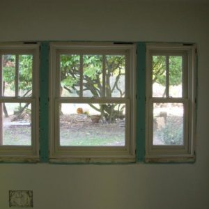

I am getting ready to trim out the windows in my new house.  I have all Kolbe & Kolbe double hungs w/ factory installed jamb extensions for a 2×6 wall.  My first question is about getting the extensions, which stand proud about 1/8″ to 1/4″,  flush with the finished drywall.  I was thinking about attaching a flat piece of plywood to my router base and setting the depth of a mortising bit flush with the plywood.  I could then follow around the outside of the extension, trimming things even with the drywall.  Is there an easier or faster way?  Everything will be painted, so a perfect fit is not required.

    I too am installing K & & dbl. hung, metal ext. , wood int. units in my new house. Here's where I'm at so far.
    I set all window and door units from the exterior w/ galv. screws, (always leaves me with flexibility). Next, prior to insul. and cover, the security sensors and wiring was installed. Then the GWB was installed and finished.
    Now to deal with the liners being prowd of the GWB. I cut squares of 3/4" ply (4" x 4") and screwed them to the perimeter window framing lapping over the liners. This then draws the unit outward and flushes it out with the GWB. There is flex in the vinyl flanges. And I also have not installed the exterior trim at this time. Once this is done the liners can be shimmed straight, square and nailed off. I then inject the perimeter w/ my Hilti foam gun (exept the large void at the bottom where I used batt insulation.
    And there I am , all locked in, flush w/ the GWB and ready for trim-out!
