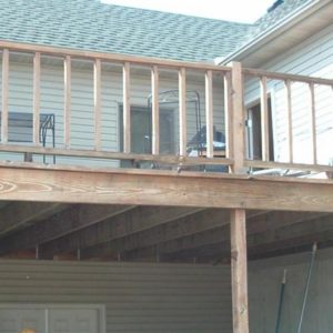

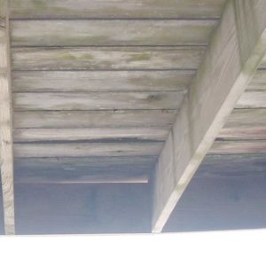

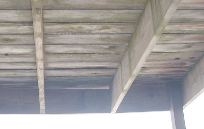

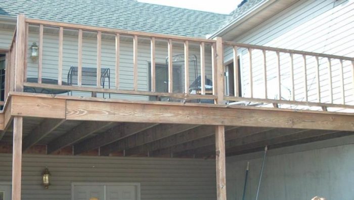

I was invited out to someone’s house this afternoon, and was checking out his deck.
Here’s a view from outside the deck, and another one from underneath.
This deck was built by a contractor – It wasn’t DIY. The band board/header is only one ply.
I pulled the HO aside and politely talked to him about it. He had no idea there was anything wrong with it.

    A tragedy waiting for failure.  How old is the deck?
    Can't believe there is no beam, and the band is pieced together like a jigsaw puzzle.  There's a wedge of daylight under the deck between the decking and band that's a real good indicator the band is struggling to hold up its end of the bargain.
    And the balusters look more than 4" apart as well.
    Pat yourself on the back for talking to him about it, and keep yourself and everyone you love off of it.
    The epitome of hack job.  Hope no one gets injured when it falls down.

      The deck is roughly 6 years old. I think I at least sorta know what happened. The builder is generally known for good quality work. But he also has a TERRIBLE temper. The deck was built when the house was done. And by the time they framed the deck, the HO and GC were at each other's throats. So I figure the builder was having one of his juvenile temper tantrums while he was framing it, and just didn't give a crap. The guy's not stupid, though. I'm surprised he walked off and left it that way.

    Stay out from underneath that thing!
  3. Piffin | Sep 06, 2005 04:06am | #3
    'ssa matta? U no likeah my work?
    Those two rusting nails that are holding up each rim joist must be at least 8d! I was gonna notch into that post but figgured dat it would weaken the upper post and let junior break it off.
    I left those ballusters 9" OC so they could throw the cat out easier.
    I guess I fergot da joist hangers on the outside, but I made up for it by using so many end nails in dem joists dere

    What's wrong with that? It has joist hangers, so everything must be fine. LOL. He's really lucky no one has been hurt there. Did he ask you to look at it to check it out because he questioned its construction or was he proud of it?

        I hope he respects your comments as fact and not a "I would have done it better" opinion. It would be a shame if your next visit is at a hospital, or worse. Maybe you should print this thread so he sees that several builders and structural engineers are concerned....that's not a mistake, it's rustic

    6 YEARS? I'm surprised it lasted long enough to install the railing.
    1/2 the deck canitlevered off of one 2x12! All the deck held by a dozen nails! Wow!
    At the very least I would have placed a post under that butt joint and then nailed the door shut.
