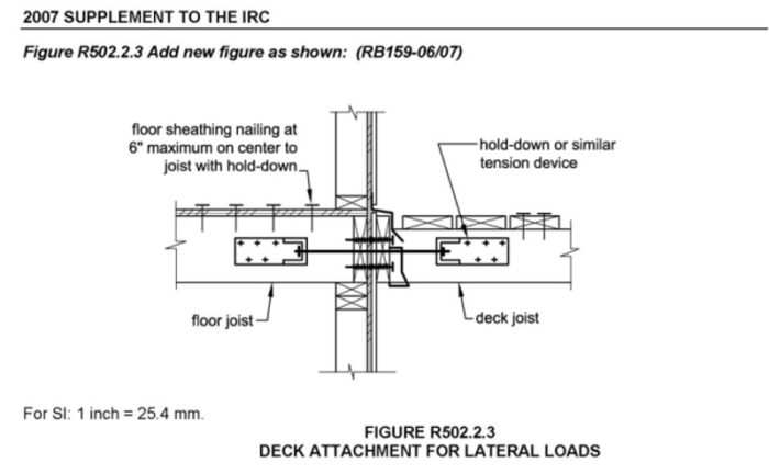

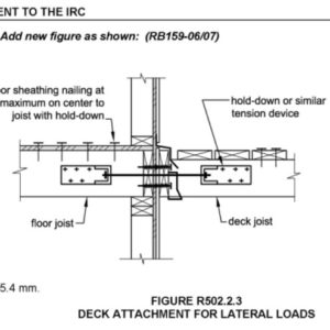

  3. gbaune | Mar 27, 2013 07:10pm | #3
    Deck Connections
    Brian,
    Your inspector may want to verify the size of the footing under the supporting wall.  The deck ledger connection code, if followed, can be challenging, here are a couple of examples.  Your situation may vary, so interpretation is in order.
