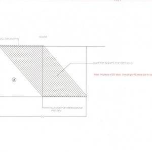

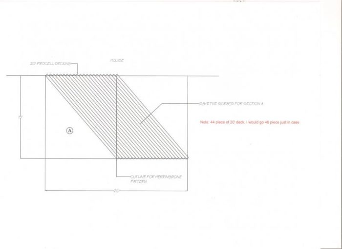

    You need 44 pieces of 20' Procell (if the decking is 5/4" x 6") I illustrate it for you in the attachment. Just divide the deck in 2 parts and start it from outside against the house and then work from outside in. Then cut the flooring (use a straight edge) and use them to begin the rest and do the samething but, cut the flooring with the same angle and start the flooring in the front and work your way to the house, then finish the rest. The only scraps will be left is the small angle cut. Hope I anwser your ?
