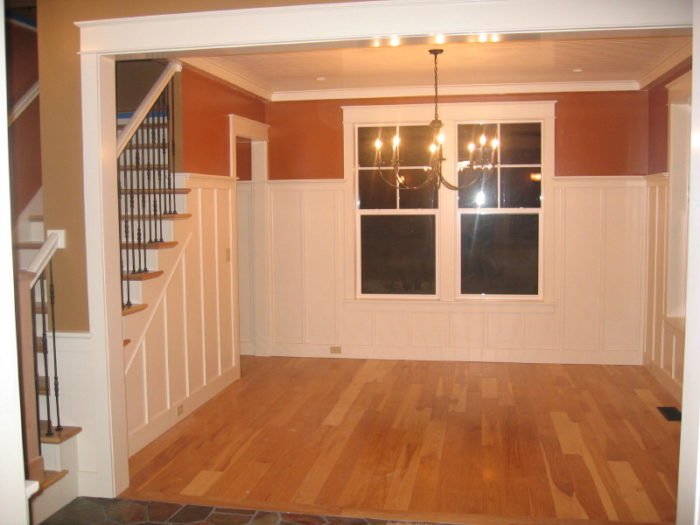

My wife and I put in Hickory floors. Not as light as maple. Has good color/grain patterns that aren't overwhelming. Has been very durable thus far (16 mos.)
That's a beautiful floor and opens up some ideas--we have a fairly open floor plan, and I've been thinking that some woods might be too uniform to suit our needs.

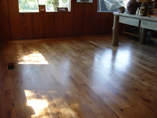

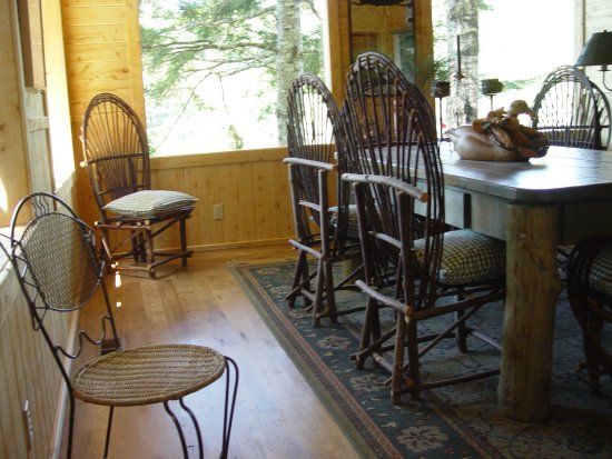

Here's some "Character" Hickory (meaning it has knots and surface defects) that I installed in a "rustic" vacation home this Summer.
The owner wanted it stained with a medium walnut stain; I really didn't want to, because it was going to look good anyway, IMO.
But, after staining, I'm glad we did, because against the rough-sawn Port-Orford cedar walls and the general tone of the house decor, it looked terrific.
(The finish over the stain is three coats of Ben Moore low-luster "Stays Clear.")
These aren't great photos 'cause I just took them for my file, but it might give you an idea of your options.
