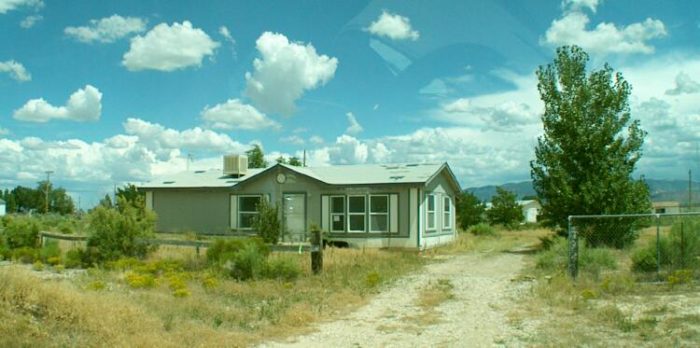

Greg, here's one, better looking than most too. This is an FHA repo, they don't sell them until everything green on the property has turned brown/dead.

Very different situation here. A trailer, and they exist, is a vehicle. Not mortgageable. Anything taxed as real estate has mortgage potential. The difference is whatever the assessor sees when he drives up, vehicle or real estate. Everybody with half a brain adds a couple of details to make sure the assessor sees real estate.
Joe's pix are clearly real estate. Haven't seen a swamp cooler in a long time though. Can't imagine anybody trying one in this climate. LOL Repos are what surprised me. Extremely unusual to find one here.

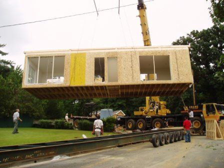

You can put a pitched roof on it. This is a 28x48 cape we put onsite on Wednesday. "Crane" shows them lifting the first box off the trailer--regular floor joists visible. There are two boxes, one is four feet longer than the other. "Roof" shows them folding out the roof, and "house" shows them adding the dormers. That last pic was about seven hours after the first.
Once the crane left the site, I don't think anyone could tell this wasn't stick built on site (it was stick built in a factory, that's all.) Just because it came on a trailer doesn't mean it's not a real house. There was never a chassis or axles or anything. The two pieces were bolted to their trailers for the trip from PA to VA; they unbolted them, lifted them onto a full foundation with a 9' basement, and drove the trailers away. Now we just have to finish siding the front and back walls and shingling the roof and the exterior is done (interior came 90% done).
