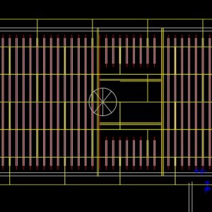

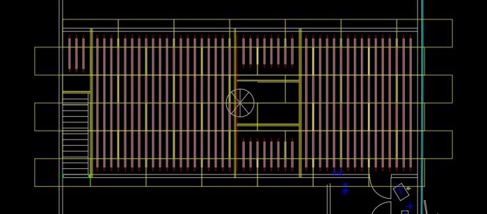

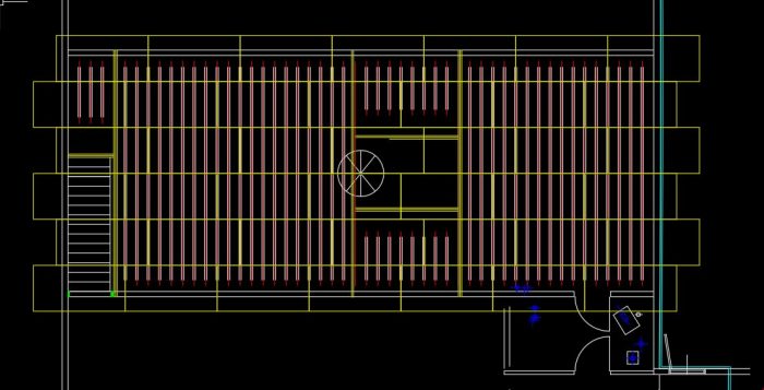

OK … I have a 22 x 52 ft attic.
My floor joists are at 12″
I have a stairway on one end and a 9 ft by 6 ft hole in the center of the floor (a large hatch to make it easy to bring things up).
So, I am just about to start laying 3/4 T&G advantech (just picked up a load).
Got the PL400 glue.
Problem … when I lay them out at 48″ offset (the way I have always done it), everything hits in the wrong spot.
I have just one joist between the hole (hatch hole and stairway hole)  … or sheets end up just a few inches shy of the holes …
If I offset by just 24″ then things line  up a lot better.
I have never seen this done … can I do this or does it need to be offset by 24″?
Thanks …. Mike
    ct_yankee | Jun 03, 2022 09:38pm | #1
    The reason for the "bricklayer" pattern of plywood sheathing is to minimize the effects of slight variations in panel dimensions. As far as I know there is no code requirement to do so. I would do what works best for you - a 24" stagger, or a 36" stagger - won't much matter as long as the panel joints fall on joist centerlines. But you may have to trim here and there to remedy panel variations.
