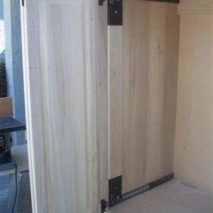

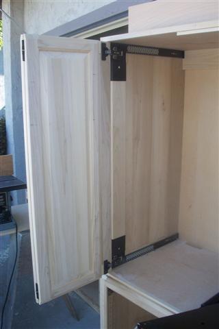

You're going to want flipper door hardware and http://www.rockler.com is a great source. You may, however, need to do a bifold (or even a trifold) flipper door - which will depend on the depth (front to back) of your cabinet. Rockler can sell you the bifold hinges, too.
Here's a picture of some bifolds I did a couple of years ago.
Looks nice, do you use the doors much. After some comments I am second guessing my need for this hardware.

This wasn't mine - I designed and built it for a customer. They were very happy with it when I delivered it and the check cleared so what more could I want? - lol
